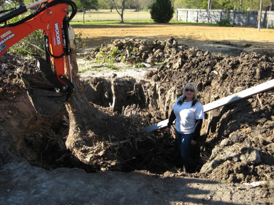

The tree was not that big. I had forgotten it died once after a hurricane in 1983 and the new tree came up from the same root ball..
Talked the wife into standing by it for a size comparison:

My limited experience with my BH80-X on an L3400, is that I can't pick up a root ball that size with the bucket, but I can roll it out of the hole with the backhoe. Then I clean most of the dirt off the ball with the hoe, and I can usually get it in the FEL bucket, hold it with my grapple, and at least get it a few inches off the ground so I can move it where I want it.

I would think that most of the weight comes from all the dirt in those roots!

My guess is 7000 pounds and a lot of it is dirt. If you can knock the dirt off or power wash it off, that will make a big difference.

My guess is that the stump itself, without all the dirt, is only about 5-600lbs at the most. Factor in the dirt, and it's probably pushing 2500-3000 lbs. Dirt is heavy!

I think 800lbs for the root ball and a ton for the dirt and rocks is a good estimate. Some rocks will be trapped by the roots. If you're unlucky they may be 200 pound ones.
