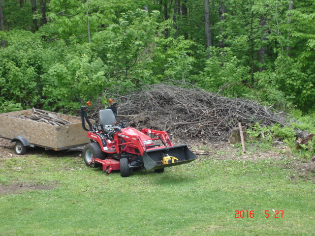

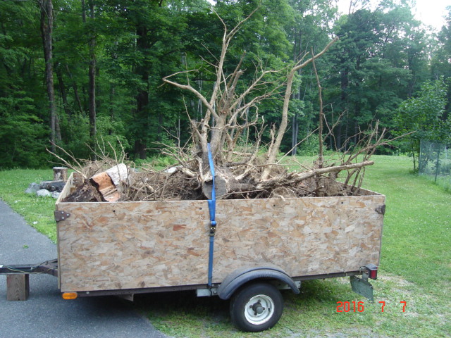

My 2310 Has turf tires with no ballast. With the BH removed (but generally with the FEL on), I've had no problem pulling a 4x8 trailer loaded with brush & logs up a fairly steep incline in the process of clearing some land. Trailer & contents, measured at the brush recycle place, totaled up to 1150 lbs. (Yeah, I had the trailer overloaded...:cool:) 4WD low range, no problem! :thumbsup: These are pretty darned capable little tractors.
