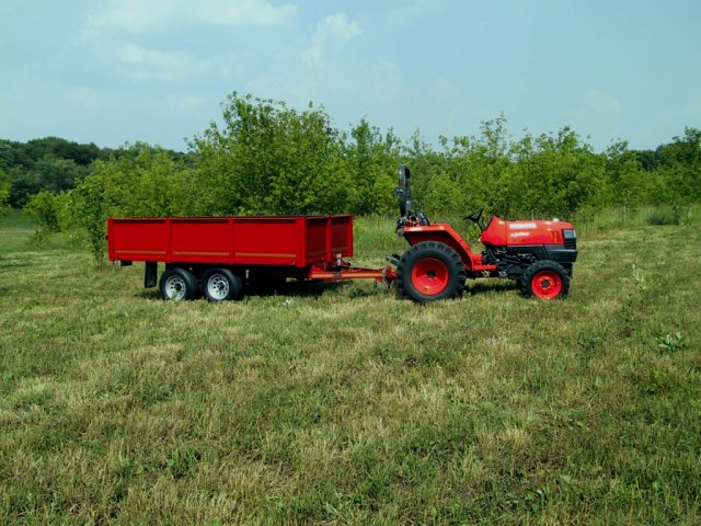

I have wondered the same thing. I have a 6 x 12 Dandy Dump, 10000 lbs, I pull with my Cummins/RAM. I use it to keep a 1/2 mile road to my cabin graveled. I thought about putting it on the tractor to get to a few tighter places. I don't know if the tractor would pull it fast enough to spread gravel. I also don't know how the screw jack would work when loaded and trying to move it from the truck to tractor. I load it myself at the pit with a BIG loader. I don't always get it exact so the tongue weight varies. I have decided it is too much hassle and just use the truck. Now that I read the weight limits I will not try it.
I do put it on the tractor for hauling when I cut brush and trees. It is great for that and no trouble pulling it at all. See Pic.

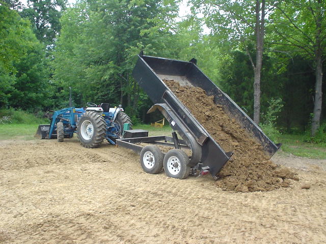

I moved a lot of dirt around the property with a 10k gross dump trailer and a Ford 1920 4wd tractor- low 30's HP gross. Pic attached. Had to bring it up maybe a 6% grade and you didn't even know it was back there. Down hill may be another matter, though. This trailer has an emergency braking system that activates if the trailer disconnects from the tow vehicle. Thought about rigging up a rope between that system on the trailer and my seating area on the tractor that I could manually pull it if things got tense. Not as good as having the tractor brakes activate the trailer brakes but a lot easier. Best thing you could probably do is load the trailer and try braking on progressively steeper grades or from higher speeds to develop a feel for stability.
