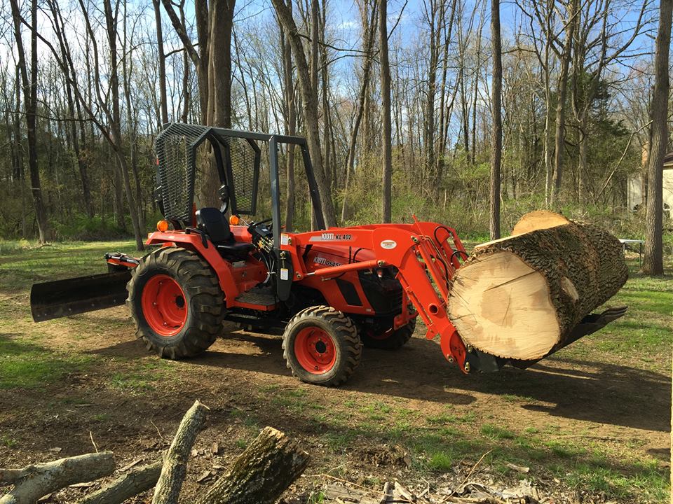

Depends on what I'm doing:
- moving loose dirt, or gravel in standard bucket - 1000 pounds of rear tire fill plus the ~200 pound brush cage seems to be plenty.
- moving medium size stumps (<2000 pounds) I'll start thinking about putting the rear blade on (extra 500 pounds and sticks way behind the eyes)
- moving things near the loaders limit - I wish I had an extra 1000 pounds. So no, I don't think it's crazy to have a 1700 pound weight on the 3 point with filled tires and wheel weights. Sometimes, that's exactly what you should have! (I will probably put a bar on the rear blade to add weight way back when needed)
In the picture I'm moving a ~3000 pound log. It was a bit unnerving. 1700 pounds of ballast and I would have greatly appreciated a lot more weight on the rear! If you look at the tires you can see how much weight is on the front axle and almost none on the rear. A previous post was right on that you want a lot of weight in the back and as far behind the rear axle as possible to take weight off of the smaller front axle. Adding weight to the back does not decrease your hydraulic lifting capacity in the front in any way. In fact, it actually increases it because it allows you to actually use the capacity of your loader without tipping.
