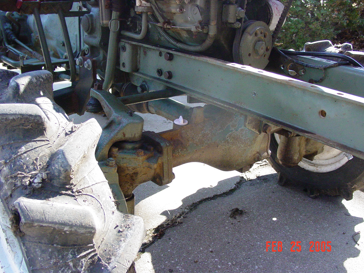

I am putting my 4wd system back together on my YM200BD but I do not have a manual. How much 90 wt oil does the front differential use and how do I check it? thanks.

My 1510D took 3 quarts so even if yours uses more because it is a bigger tractor, it probably won't take much more than that. My tractor has a dipstick on the top of the axle. If you are facing the tractor it is on the left side. To drain the old oil I removed the dipstick and there were 3 plugs on the bottom of the axle, one one each side next to the wheel and one in the middle under the front differential. So I would look for your dipstick first so you have a way to check oil level when you refill (plus it helps to let air in as the oil comes out and you will need to put the new oil in there. Mine is yellow if that helps and it unscrews).
   / how much 90 wt. oiil in front end? #3
Here's a pic of the cap on my 1602D, same as Roxy's 1510 I think. Don't know if your 2000 is the same or not..........

hey thanks guys. That is just the info I needed. I already have all the oil drained due to taking the front diff. shaft out and putting in new seals. Thanks again.

Yep, looks the same as mine.
