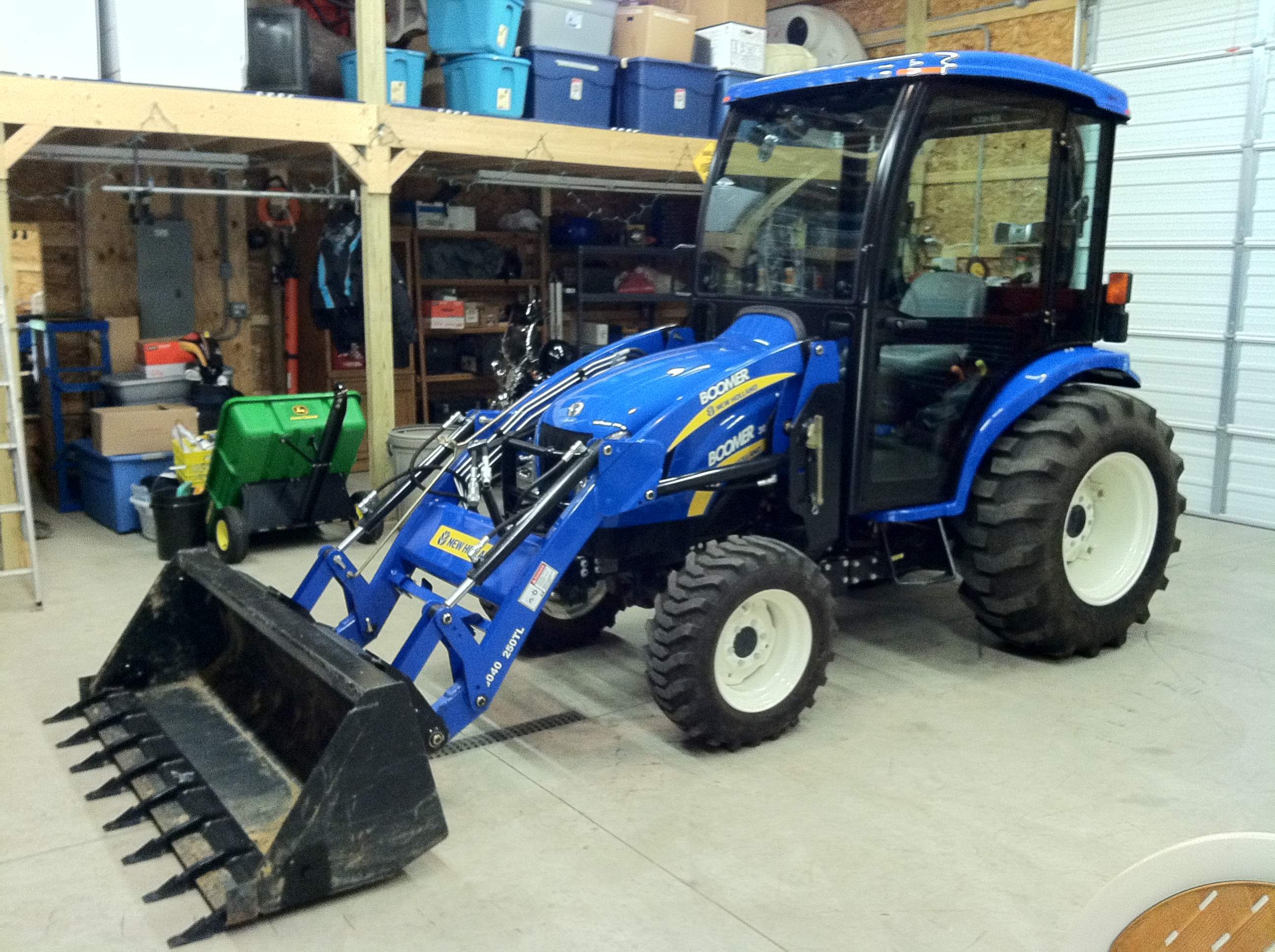

Here's a photo of my 72" bucket that has 8 teeth on the bar.
