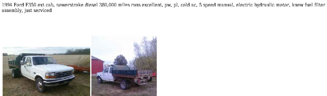

I'm looking for a 1 ton pickup with dump bed for towing my Kubota L35 with and other uses.
I have a few questions:
1.) In general, what is the Combined Gross Vehicle Weight on a truck this size?
2.) Does 380K miles mean there is much left, engine life-wise, with this truck? Does the mileage scare anyone off?
3.) I've seen many of these trucks come equipped with gas, V-8 engines in the 350 c.i. range. Is this enough motor for this kind of a truck? They must put rather tall gearing in their rear axles, 4.50-ish or greater.
4.) Do I want to find one with and auto or manual transmission? If you'd relay your reasoning for why, it'd be greatly appreciated.
Here's one that I've found and wonder what the 'horse-traders', who know far more than I, think.

It's got a great engine, the 7.3 diesel, but IMHO 380K would send me running. That's a LOT of miles and you don't know if they've been easy or hard miles.
This year I bought and sold a 94 F350 with the 460 gas. It had some manifold issues but I put several hundred bucks into it and used it all summer. It served it's purpose well. I have seen these 1 tons with a 5.4 V8, and would NOT get one.....the 460 was just able to pull a full load of dirt or gravel.
I will probably get another dump in the spring, but either a F550 - sized vehicle or probably step up to a 650/750 or an IH.
Either way, I will be looking for under 150K miles, (preferably under 100K) and definitely prefer the diesel. For a gasser, either a 8.1 or V-10, no 350 sized dumps.
Good luck!

Great advice. These 7.3L machines are frequently seen running at 300+ K but by Ford's own admission that is heading into rebuild time and frequently they are getting a little tired at that point. I am not a good speller (at all) myself, and do not want to sound bad, but when I am looking at adds like this, presentation means a lot. The fact the add misspells "knew" is not a good sign. That is not that tough a word and when someone either places or approves an add with that oversight, it makes one wonder what attention to detail might have been present on their truck use and service. For the two reasons I noted at least, I would pass on this machine.

There's a good chance that truck is not a Powerstroke and is the old non-turbo IDI 7.3l diesel which is what I had in my 94 F-350 dump. The Powerstroke came out in late 94 as a 94.5 model year but very few 94's actually got it and all 95+ trucks had it. The non-turbo diesel is a dog and pretty useless with 2-3 tons in the bed but very reliable. The GVWR of my truck was 11,000 lbs and I couldn't find the GCWR but found online in a few places that the tow capacity was about 9,000lbs. Hardly much considering today's trucks.
If I were looking for an older dump truck again, I would only look for a Dodge Ram with the Cummins diesel. You get a solid truck with a diesel engine that has no problem going 300k-400k miles untouched and a more comfortable cab.
My dump truck had a sander in the bed 90% of the time and you could tell because the dump bed and truck frame rotted away so bad it could hardly hold itself together. Check the frame and bed very well, new paint is a bad sign.

The truck you have listed seems like a decent truck. From the photos, it appears to be in decent shape, not major rot issues. At 380K, I'd expect it to be primariy worn out. Expect the engine to need a rebuild/replacement and same with trans and rear axle. Price should reflect that.
