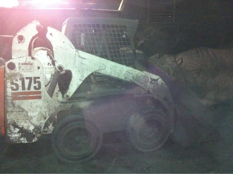

Sorry to chime in late but I thought you'd be interested in knowing the life of torture our S175 bobcats endure inside our gray iron foundry. We have 2, the older one has 6129.2 hours and runs all day hauling and rolling hot sand and iron castings and runs in extremely dusty and downright filthy conditions day in and day out. These machines get so full of sand we need to clean them out just to operate the foot pedals. It was bought in 2003 if I remember correctly and has had no major repairs. Greased daily, monthly oil and air filter changes. I have no plans to replace it anytime soon. My newer one was bought in 2009 and currently has 2500 hours.
