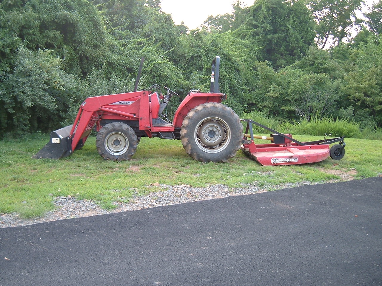

one more attempt:rolleyes:

Well your machine doesnt look to be in bad condition. As FWJ has given you some very valid points on what can happen to a tractor if uncared for :mad: And likewise how many hours you can get out of a machine that is maintained. Looks like youve got the same loader on your machine as mine. I think its the MF-232 if I recall.
