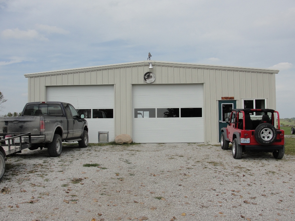

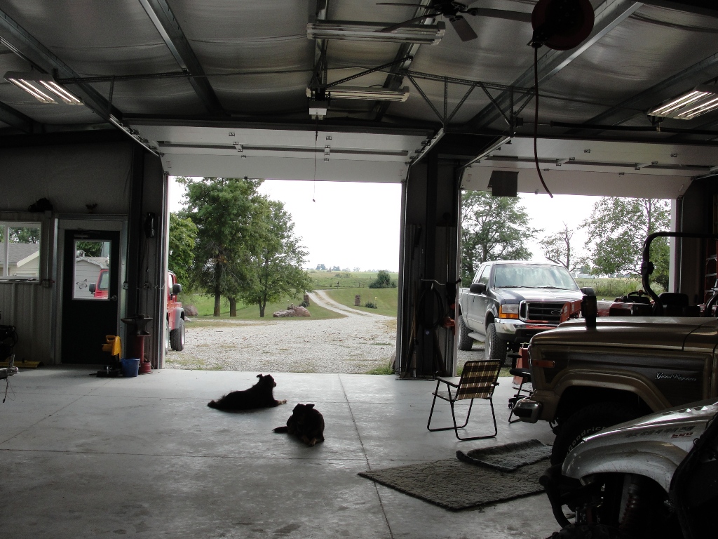

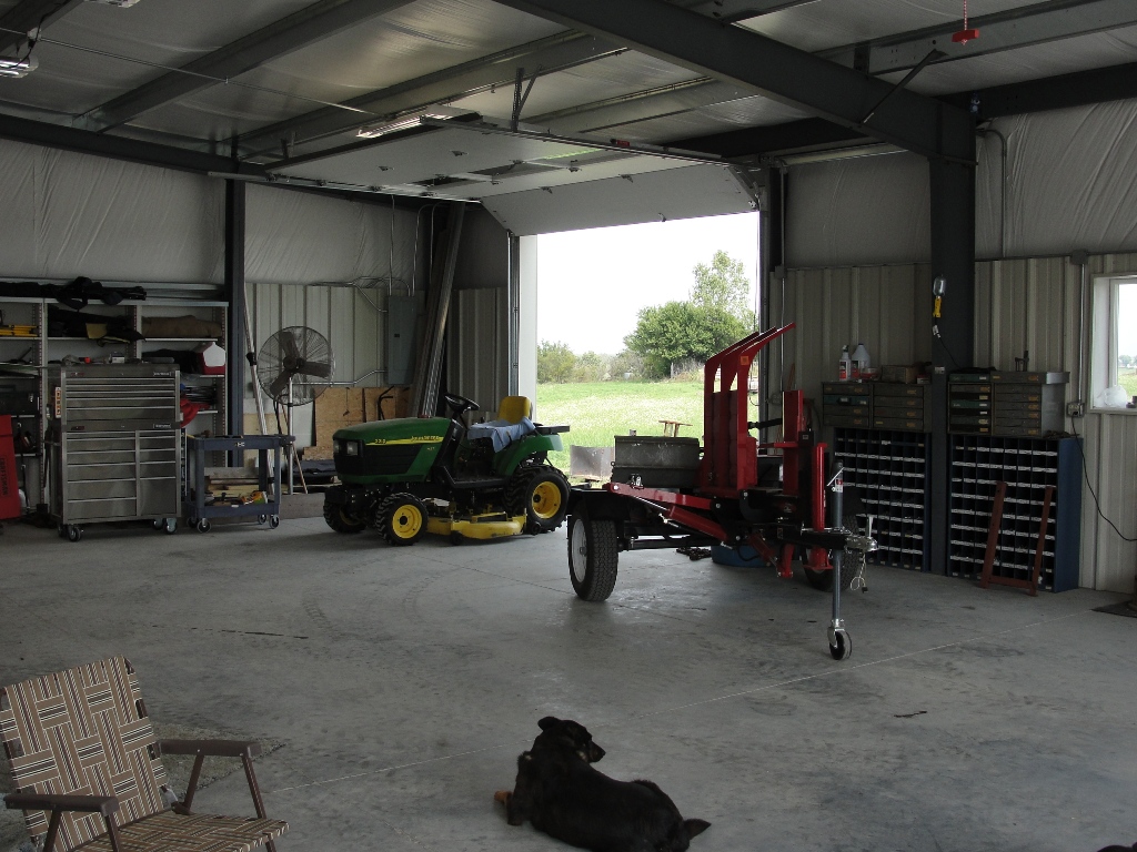

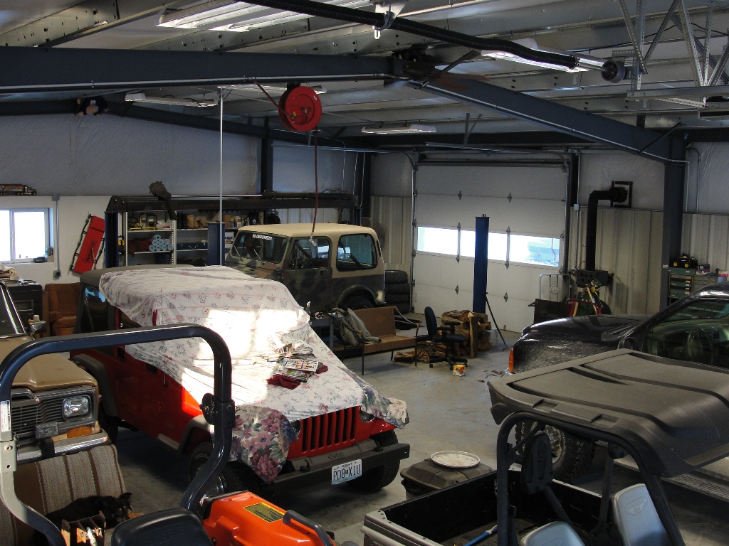

Here's my building, 42x50, three 10Hx12W rollups, one 36" walk thru. Should have put another walk thru on the eave side by the single rollup. As the shop fills it becomes even more critical about door location and size. I wouldn't consider a door narrower than 10ft wide. Also wouldn't consider a walk thru narrower than 36" You're gonna love having a building. My wife says I should have put a bedroom in mine since I'm always there!!! :thumbsup:
