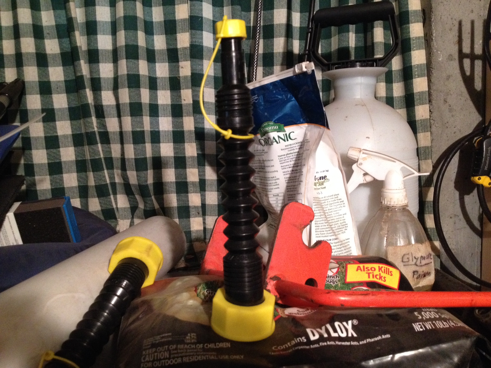

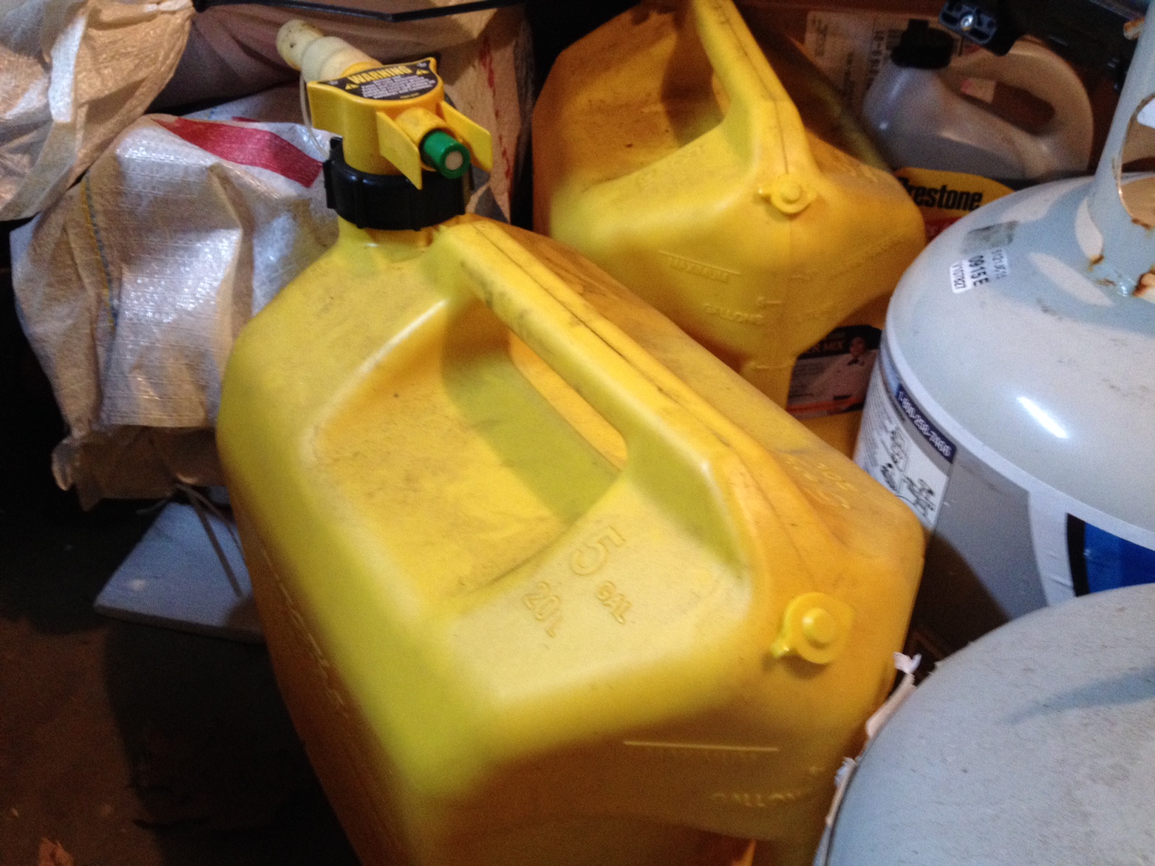

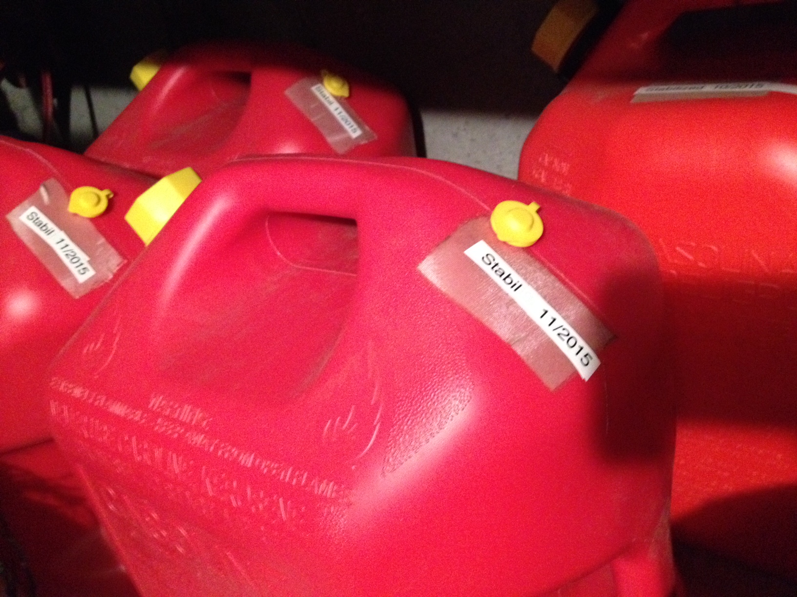

I have decided that one year is my mark. I use Stabil marine. Better than the red stuff. My 12 gallon marine tank that runs my two generators gets changed once a year, drained into my SUV, and then refilled and restabilized. My eight, five-gallon cans get used throughout the year on things like my splitter or mixing for the saws and 2-stroke stuff. They also get stabil marine, and labeled with their stabilized date. When a year approaches, they too get dumped into one of the SUVs and then refilled, restabilized, and relabeled. I have never had an issue what-so-ever with any of my gasoline like this. My diesel, well, I wish I could say I store it, but I have so much fun (and projects) on the tractor that I burn through it fairly quickly. It can safely be stored a lot longer than gasoline, but not sure what the cutoff is.
One point that I will mention. If you are going to be rotating gasoline cans into cars, or whatever, do yourself a favor and buy one of the Easy Pour spouts AND PUT IN AN OLD-STYLE VENT to make it not such a chore. I used to spill or leak so much gas out of the govt. safety nozzles. They are all in the rubbish now. I bought a few EZ-Pours and put vents in all the cans. I also bought solid caps for each can. Easier to store without that big spout sticking out the top. Leak-proof and convenient. I even put vents into my NO Spill cans. The ones with the green buttons. I can now dump 5 gallons of diesel into my tractor in 40 seconds, without spilling a drop. Big improvement.
