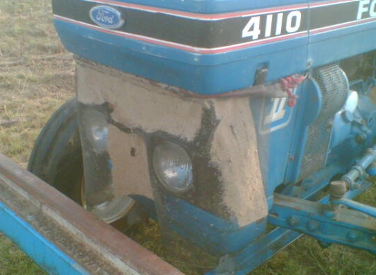

Mowing dry grass atomises the grass fibre and quickly blocks the radiator along with seed etc. Hang a piece of fly screen across the grill. When this clogs you simply shake it clean. Saves lots of time cleaning the grill and radiator on the job. Picture shows clogged screen ready for shaking clean.
Best, Ged

Ged, if you could sell that lint, you'd be a rich man.;) My tractor has built-in fine screens around the hood and they often look the same way while mowing. Your doorscreen looks to be just as effective.:thumbsup:
   / How I stop the radiator clogging up ... #3
That's a good trick... I had to stop 3 to 4 times a day to blow off the screen... but at least I grab a cold one at the same time :licking:
   / How I stop the radiator clogging up ... #4
Thats a great tip, i also do the same thing on my 1910!
