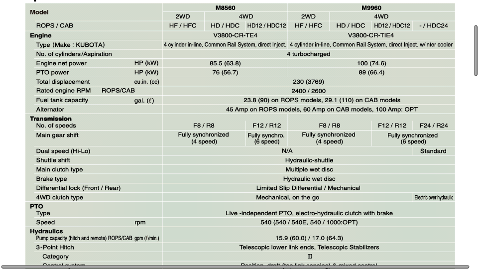

Ive never seen kubota advertise m8540 as cat 1/2 i believe this feature stops at the m7040 you would have to have different lift arms on my M8540 or cut the bushing out and replace them. I would agree i would never put cat 2-1 bushings on any ground engaging equipment.

I wonder why they use a 3/4" pin for the tractor end of the top link then? :confused:
I'd guess would have to see it to believe it. Where did you run across the 3/4" pin at? Not sure if they changed at some point but both ends of my toplink on my m8540 are 1" as well as the pins
