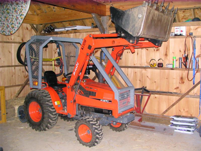

Thanks Steve. Obviously I wouldn't have written this if I didn't think there was a chance that you're right. I'd still really like to know what the axle ratings are.
The cage is actually structural and it takes some strain off the middle of the tractor by tying the front and rear of the tractor together at a second point besides the transmission / engine connection. The loader frame seems over built for the current cylinders. So my biggest concern is the front axle.
The only thing I know about the front axle is that I once stood the tractor on it's front axle with a full load of stone in the bucket and filled rears when I dropped the front into a ditch at speed. My frist thought was "$#@, I just broke the front axle!". But I was wrong. there was no damage. Has worked fine ever since.
So it seems if I were careful the front axle could take a little more lift. However, I'd love to hear from design engineers. i know there was one on here who was involved with the loader. I'd also love to hear from anyone who has pushed their tractors lift capacity without issues or with issues.
I'm adding a picture of the cage I recently had built so you can see how it connects the front and rear of the tractor.

Thanks for sharing this.... So it seems that if I increase loader lift, I should perhaps increase 3 pt ballast as well from the current 700 pounds to maybe a little more than that, or move the weight back further (currently at the lower link eyes), to compensate for the stronger loader with the potential downfall that I am more likely to break the tractor in half, which i don't think will happen with the additional overhead "frame". I could also fab a sub-frame. Now to find some cylinders!

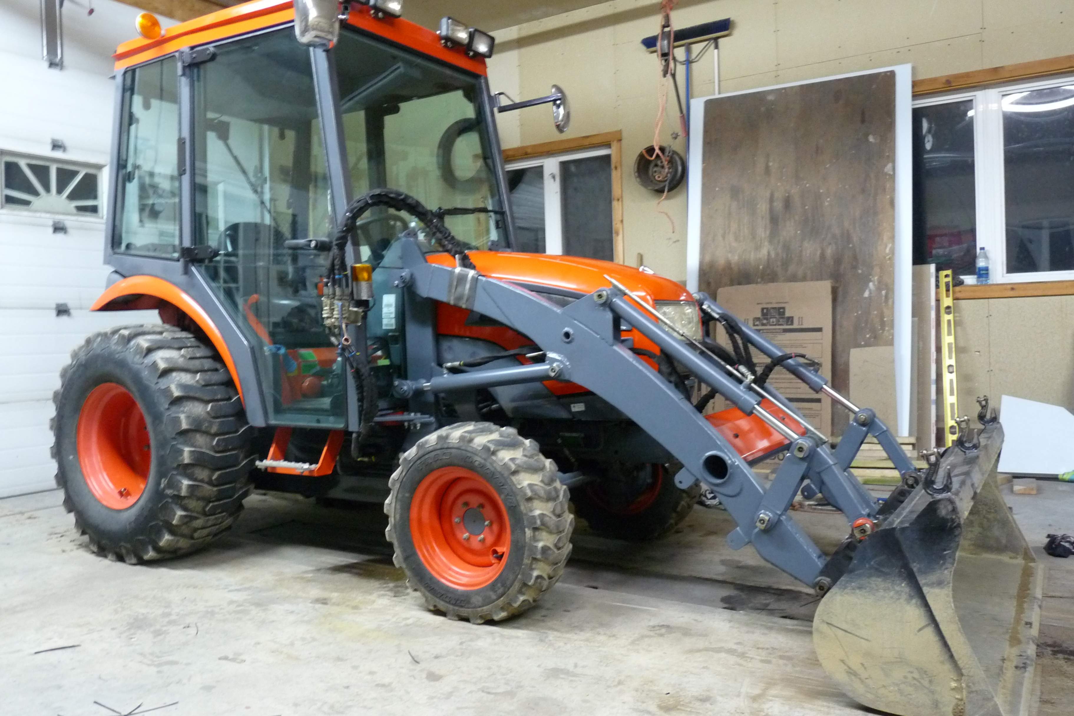

I own a CK25HST. I modified my loader to have stronger lift and curl.
I spent weeks looking at other tractors and compared them to mine.
I found brand new Kubota tractors with about 40 hp and much larger loaders
that extend further forward than the CK models. I found the larger Kubotas used the same size steel cross plate (where the pivot bearings attach to) as the CK models and the front axle in the CK is beefier than the Kubota.
The castings may have thinner walls on the CK but not likely as the Kioti is a heavier tractor. My stronger loader has been used a lot in dirt and rock since the mods but I don't slam things around. I try to be smooth and have been more than impressed with the results. My loader is now very sturdy and precise. Feels like a commercial loader. I did add a substantial under frame to remove strain from the transmission housing and I do keep lots of weigh on the 3 pt. hitch.
I also built the heated cab.

Beautiful job on the cab! Thanks for your post. It's great to hear from people who've gone there before you...
I feel the same way about the build of my tractor versus others with similar lift / curl capacities. The lb1914 seems way over built. Time will tell. I'll probably wait a few months at least to do the cylinders since my wife wants a fence, kids want a play set, wife wants a stone patio... Hmmm... I should tell her I NEED new cylinders to build the stone patio! he, he... always think'n.
How much did you increase your lift and curl? From what to what?
I'll tell you, weight on the rear is great. This evening I was doing loader work in 2wd and I thought I was in 4wd. Didn't realize it until I put the tractor away. But I guess I have an extra 1,800 pounds on the rear compared to an unweighted LB1914.
You're loader looks great too with the new paint job! It makes the whole tractor look more industrial.
I'm attaching some pictures of my $30, 700 pound rear ballast and cage.
