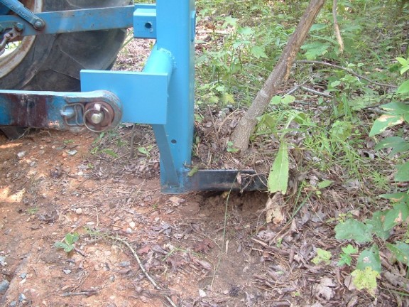

I'm planning on using my tractor to aid me in repairing & clearing some fence rows that have been neglected for several yrs. There is a 2 to 4 ft band of saplings and brush between the fence rows and mostly open meadows they enclose. ranging in size from 1/4 to 3 1/2" in dia. a very few Up to 4" Haw,persimmon,plum,blackjack pecan/hickory,sumac native holly.
I have taken down & removed several larger trees & stumps on my property in the past, using my 4wd jeep or a buddy's 1 ton w/jin poles & winch, but I have no experience using a tractor for this kind of thing. Much less, one that has the hp & weight limitations my 1610d w/fel has.
I ran a few searches of the archives on grubbing & brush/tree clearing.
I found some good info + ideas on some implements that might complement the the tractor and be fairly easy & cheap to fabricate. (good sources of oil field pipe & scrap) however, a lot of the implement & technique successes described, were with much larger tractors than my yanmar. Figured I would just go out and see what I could do with what i've got, & go from there. In the mean time we have had about 10 days of rain & mist here in N.E. Oklahoma.
So I thought while waiting for things to dry out I would ask you folks what techniques or implements you use to clear your property, & what I might realisticly expect to accomplish with my 1610d. Below are pics of some implements I thought might compliment and best utilize what the 1610 has to offer. (keep in mind this is my first tractor & I have no realtime experience to base my judgements on.)

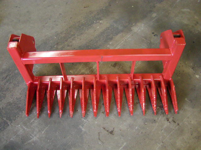

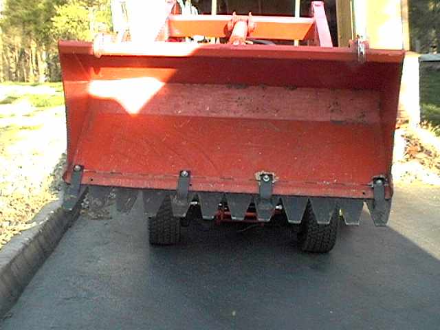

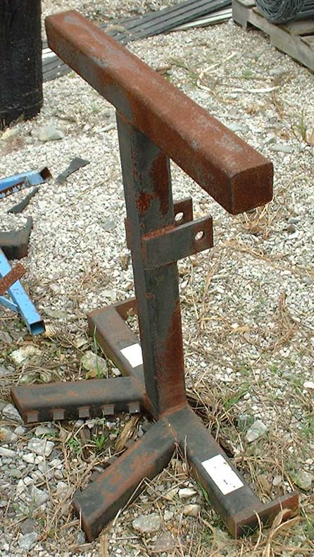

A bolt on tooth bar based on pics 1&2 would seem to be useful for grubbing out the smaller stuff and easy to fabricate. The 3 pt puller/grubbers in 2&3 also should be fairly easy to fabricate & should give good traction by pulling down on the back wheels while pulling up w/hydraulics & fwd with the tractor. I'm thinking the weight of the fell + filled tires on the frt end will help to keep all 4's on the ground. Your experience, advice & suggestions Will be greatly appreciated.

I'm not sure about the 3rd picture tool,:rolleyes: if you have a FEL I'd think pushing up to 3" tree's over, then scoop them up by the roots with bucket would work better, but that just MO!
I would be interested in seeing the 4th picture tool at work;)

I've been tackling a similar issue with my YM1600. Alone, it try's, but just lacks bulk for going after larger root systems. Being patient I'm slowly clearing things up and still have a long ways to go. I tried the 3pt Grubbers but not enough tractor to do much good. So, devising attachments that give my CUT an advantage is necessary.

bob,I've got a 1610d and use the front end loader to knock down 1-11/2 samll trees and mostly buck brush with pretty good success,i've eaven used my finish mower to cut some of the smaller trees/saplings after knocking them down with the fel.if i just have to I,ll always pull from the front like norm said.lot safer.if allelse fails i break out the axe or chainsaw. I've thought about using tooth bars but don't know if they would work that well on my size tractor.russ
   / How good r our little Ym's for clearing fence rows & pulling trees ? #10
bob,I've got a 1610d and use the front end loader to knock down 1-11/2 samll trees and mostly buck brush with pretty good I've thought about using tooth bars but don't know if they would work that well on my size tractor.russ
I'm think about the tooth bar myself, it certainly could take a FEL to the next level, from what little I have used my FEL it has been very impressive with just the cutting blade I can only imagine if had teeth it would work that much better, especially while digging up small trees by their roots etc,
