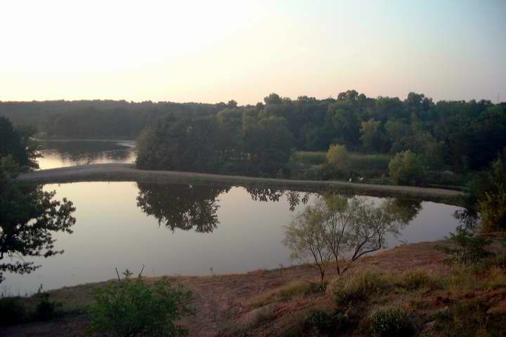

I just mowed around my ponds this last weekend, and I mowed the pond dams all the way down to the water by turning and backing down the slope on each side of the dam (pond on one side, lake on the other). These dams are so steep I can't even walk up and down without slipping, but my tractor does it with ease. I'll try to get some pictures to show you what/how I mow the dams. I'll shoot a couple of photos tonight (Tues. night) and post them.
Of course, I do this with a TC45D. If you don't have a hydrostatic transmission, I don't recommend this method.

   / How far is too far? #10
Here is a photo of one of my ponds I mow around by repeatedly backing my rotary cutter over the edge. With my hydrostatic tranny, I can do the whole job in a little over 1/2 hour and never even touch the brake. Having water on both sides of the bank makes me always pay attention. /forums/images/graemlins/smile.gif
