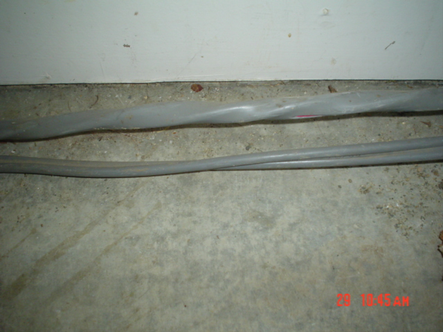

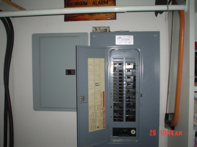

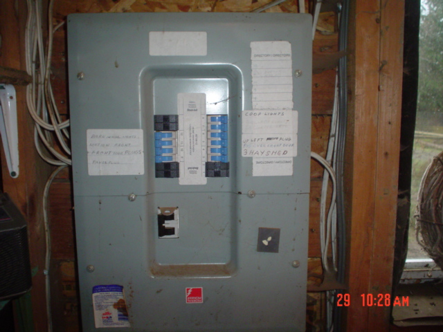

The maximum distance is strictly a function of load and wire size. The heavier wire, the less voltage drop and the more load it will support.
I have three barns feed serially, the furtherest about 600' from the house, the nearest about 250'. The previous owner had the nearest set up for a welder with a 100 amp feed (#6? copper, I'm not sure without looking).
The newest, most distant barn Lowe's didn't have the #10, I wanted, so I ended up with #12. However, the compressor won't start out there, too much of a starting load. I'm sure if I had #8 going all the way out, it would be fine.
I agree, run 220 (3 wire plus ground) and put the space heater and the refrigerator on different sides of the 220/110.
