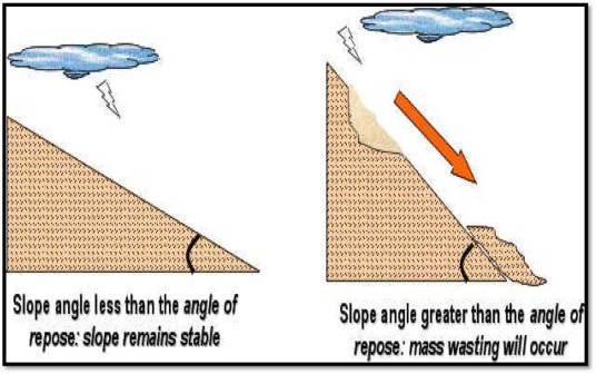

A lot of it depends on the angle of repose.
from here:
A review on the angle of repose of granular materials - ScienceDirect
If you cut across a material that is already at or near the angle of repose, it's gonna collapse. If the slope is less than the angle of repose, it's possible to cut across it and still have the material above the cut be less than the angle of repose.
Water soaking into a material can change its angle of repose (think dryer concrete VS watery concrete) and it'll then give way.
Water running across a material can wash it away as well, which also changes the degree of the angle of repose.
You can build structures to anchor into a steep slope and then backfill them to make a level path on top of the structure. You'll still have to contend with water, frost, etc.... all that stuff.
When I was a kid, we lived at the top of a 90' escarpment going down to a lake that was greater than the angle of a repose of the soil. However, it was heavily wooded and the trees and shrubs anchored the soil. My dad built steps out of broken chunks of sidewalk concrete, usually in 12-18" slabs that he stacked up on piers dug into the hillside. Many switchbacks, piers, retaining walls, etc... but every so often, one of those large trees would tip off the bank, take it's roots out with it, and then the soil would collapse down the hill. More retaining walls and repairs to the steps on an almost annual basis. In a nutshell, it was not a good place for that type of staircase. He'd have been better off sinking deep pilings into the slope and building wooden steps.
