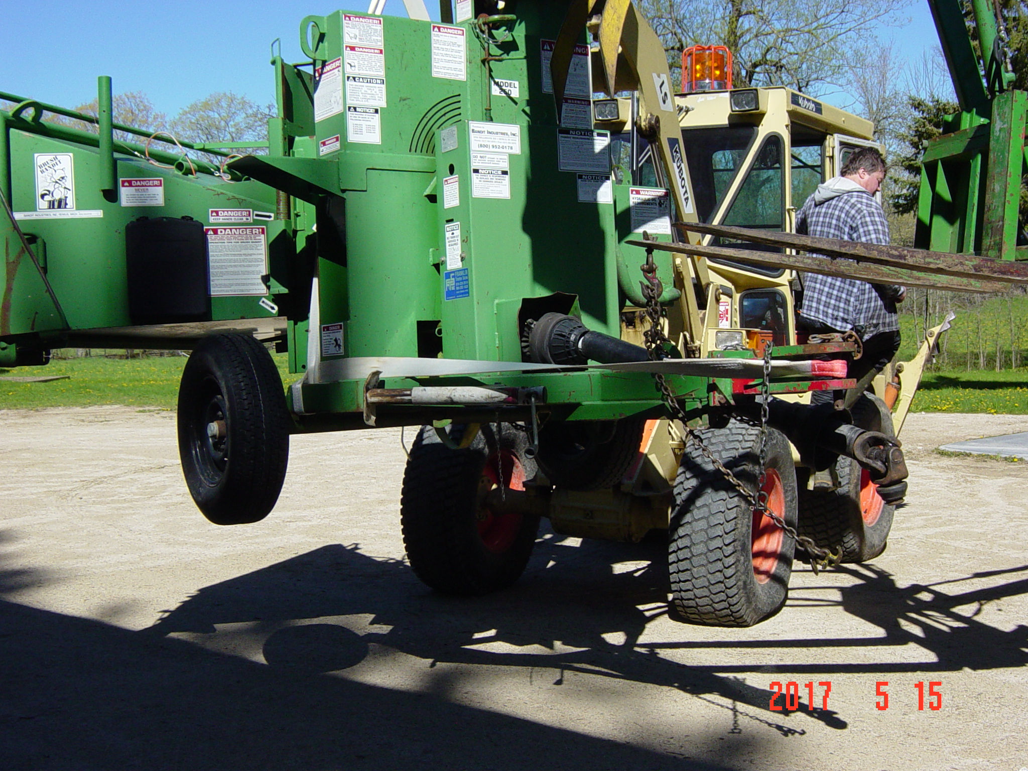

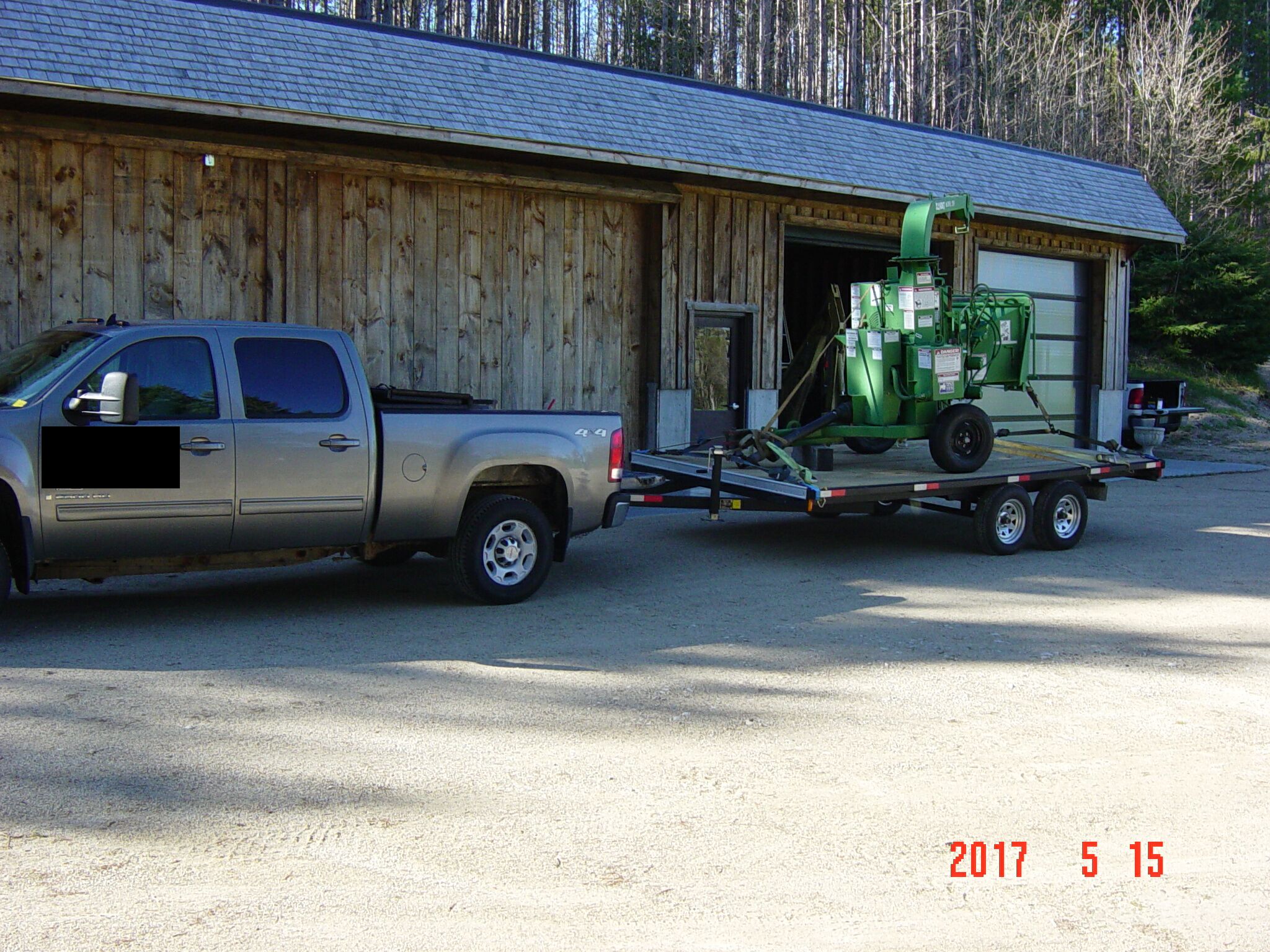

I have a 14" chipper with a thousand pound flywheel. It troubles me to engage the electric pto clutch. There is a slip clutch on the chipper, but it only helps so much. I give the pto a kick, then release and re-engage. Don't know why, but this seems easier on the tractor.
   / How does one use a PTO chipper with an electric PTO clutch? #8
Wow, would you mind posting a pic of that beast? The gyro effect of that bad boy must alter the planet's rotation!

Gladly. I love posting as well as looking at pictures. No pictures, it never happened!
Arriving home from MN.
Unloading
I need to take some pictures while in use.
