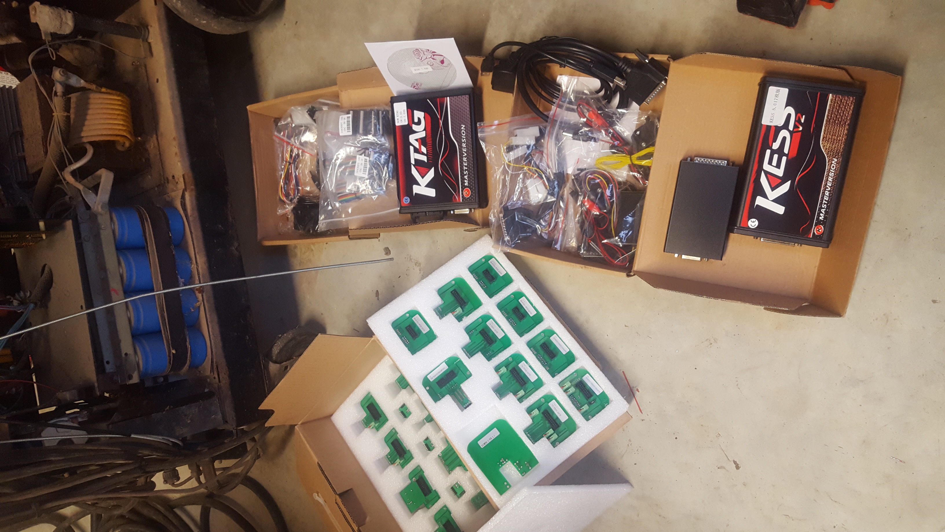

Thanks for reviving this thread. I forgot to update it. Last month I received this bundle of wondrous ECU tinkering tools in hopes to one day do some "tuning" on my tractor.
The fact that the XR4155 has the same exact engine and everything, but 38% more horsepower, is something I just can't get past. I'm going to get that extra 15hp one way or another. But before I get there, I have a lot of learning to do. And a warranty. I have a 2007 ford focus I'll be experimenting on. If I brick that ECU I can easily get another one from a junkyard. A few years of brain surgery on cheap cars and maybe by the time my warranty expires, I'll have the balls to crack the tractor's skull open.

I got it from eBay out of China. It's called Kess and Ktag and you probably shouldn't think of it as a diagnostic tool. It does have some diagnostic features but this system is mainly used for extracting and re-mapping (flashing) the chips in ECUs. I would strongly encourage you to do your own research and decide if you think it will work for what you have and do what you want. As far as hardware goes, it comes with every interface board and cable and jumper and pin and whatever needed to interface with any ECU on the market, from motorcycles to boats to dozers to minivans, but software support has to be written for each vehicle. I arrived at the conclusion that this system would work after extensive research and lengthy reading on Russian/Chinese ECU hacking forums. There is no software support explicitly for the LS XR tractor that I could find evidence of, but they do have the Case IH Farmall 40C in the database, which should be the exact same as my LS XR4140. Same engine, same ECU, same tractor, different color. So in my mind it was a relatively safe gamble. I haven't tested it yet. I just unboxed it to take the picture. I will update this thread once I do.
If you want the legit interface that LS uses, it's called Carnics UVIM. I can only find that for sale from a single seller on Alibaba out of Korea, who has not replied to any of my messages and seems to have not logged in in months. Maybe he was "offed" by the Korean mafia at the behest of LS. And even if he were reachable, the listing does not include software. I cannot find the software anywhere. It's available for download at the LS Korea website if you have dealer login credentials but I don't. Since the Case IH tractor is the same and the New Holland Boomer 40 is the same, either of those softwares should work (I assume) but those are equally well guarded, albeit with more interest and more avenues to acquire them. The pirated New Holland software is available on eBay but I refuse to purchase it and I recommend the same.
