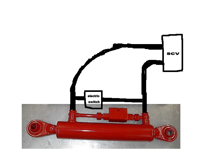

I plan on adding a Top & Tilt (with two tilt cylinders) to my JD4300. I already have the 3rd, 4th and 5th SCVs. I would like the top link to be able to float so that when I mow with the bush hog or rear finish mower they will have a greater range of motion and follow the contours of the land better. Most top link setups have a check valve to keep the top link in the set position. Is it possible to have a check valve and still have float?

For the top link put a T at each end of the cylinder and connect with hydraulic line and an appropriate valve. With the valve open fluid flows from one side to the other and the link will float. With the valve closed it acts as per usual.

Like Jeff said, you can't do it. The valve on the tractor has to have a float and the cylinder can't have the check valve.

Steve's idea should work. The "appropriate valve" would be some sort of ON / OFF valve. When the valve is open the cylinder should float, but to extend or retract the cylinder you would have to close that valve. I suppose if you tried to operate the cylinder (either extend or retract) with that valve open, it would feebly extend due to the smaller surface area on the rod side of the piston.

Hi Steve: Your idea is what I vaguely had in mind and you have help me visualize it.
I made a crude drawing:
Float circuit
Gut wouldn't the differences in volume caused by one side having the piston displacing fluid make this not work?
Marshall
