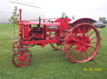

Lets see, heavy and cheap, hope you don't mind old. Guaranteed no flats!
Ya, I know, I'm a smartarse.
I'll get my coat.
