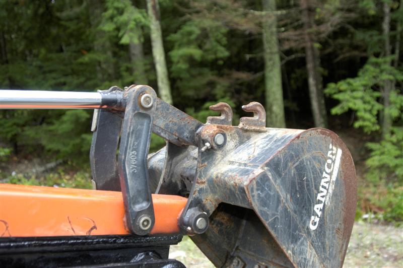

Here's what I use on my backhoe buckets.
Both buckets have them facing so I can curl to tighten the load which brings it closer to the dipper stick for more lift. One has them facing both ways for far out work when I uncurl.

The chain hook on the back side of the bucket is correct as Rob shows. You typically would want to start with the boom up all the way the dipper stick down and bucket curled. Hook on to the load and attach to the bucket mounted hook with the chain going along the BACK side of the bucket. Then extend the dipper stick to raise the load. The bucket can be "uncurled" to raise the load more.
For your back blade in the truck. Back the tractor to the truck with the boom up and the dipperstick horizontal. Lower the stick with bucket curled to hook the chain. Raise the stick to clear the truck bed. Have a helper at the truck bed to keep the blade from rotating. Or, once the blade is just off the bed, have someone drive the truck away.

Here's where I put my hooks. They work great, having the two side by side allows me to take up slack on the chain when needed.
