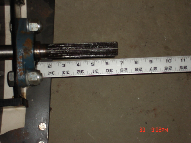

dnw, the spring-loaded ring on the mid-PTO driveshaft is, as mentioned, at the rear. Grasp the ring, slide it toward the front of the tractor, and the whole driveshaft should then slide forward and drop off the rear. The front connection is a splined shaft that's supposed to be lubricated and should slide in & out easily, so it can be pulled rearward and off. That rear spring-loaded connection operates just like an air hose chuck.
See the pic of the manual: there's a critical distance that the splined shaft needs to be protruding from the quick-hitch "shoe" mount at the rear. Some folks have had that snowblower driveshaft fly off (not pretty). There are a pair of set screws that secure the short splined shaft in place there; guess they sometimes loosen up.

driveshaft ext.JPGcorrected stub.JPGdriveshaft splined end.JPGQuickHitch man. p.14.JPGblower & dolly.JPG
