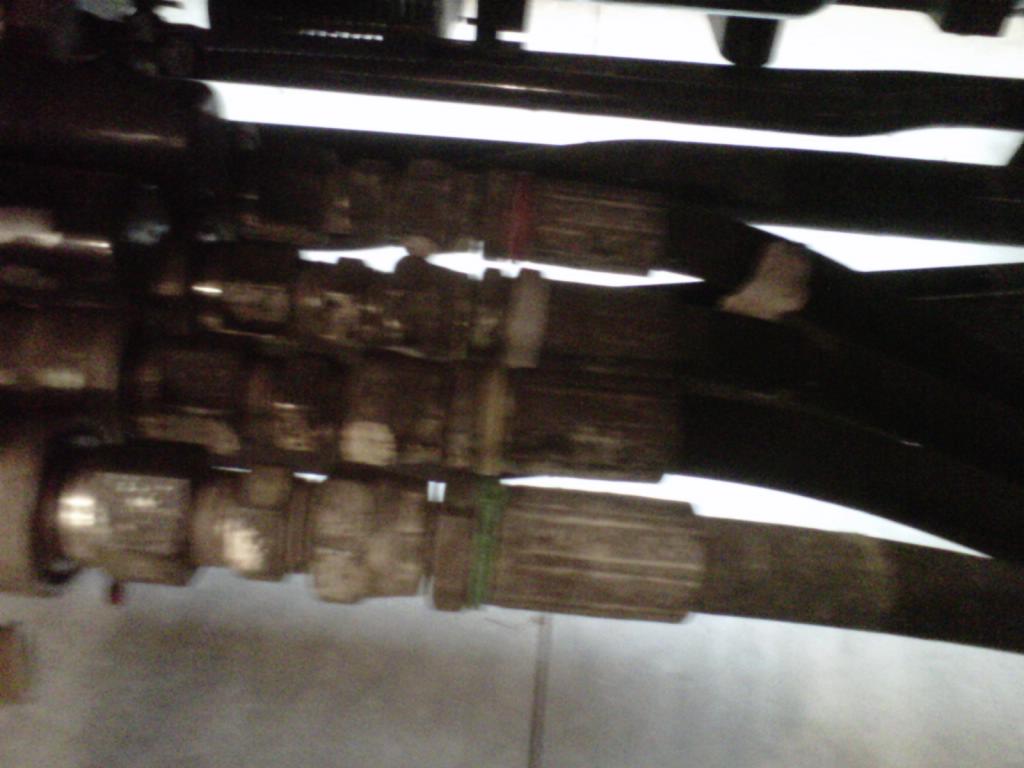

Ok, first one of my few gripes with my DK45SE - just about every time I bush hog, at least one of the quick connects for the FEL hoses under the step has a hose disconnected. I know I'm a bit aggressive bush hogging, but I'm trying to reclaim pasture that hasn't been mowed in years, so a lot of saplings. Couldn't Kioti have put some type of protection around the quick connects so that this doesn't happen?
Most of the time, it is one or two hoses and I have to horse them on. This time, all four hoses came off and I'm not sure which hose goes to which quick connect (one hose was up the sleeve around the hoses and when I pulled it out, not sure if I messed up the order).
Anyone know an easy way to match hose to quick connect? Anyone have any home made solutions to keep the hoses connected when plowing through brush?

On my MF they put colored cable ties on the hoses to match up the connections. On the farm we always spray painted a small section at the end of hose to match up . With as many as 8 couplers it would take forever to trace lines and get them in correct coupler . Mark all of your implements , and life will be simpler :thumbsup:

Your ends should be color coded.
If not you will have to follow the line down from the loader cylinders.
I know the inner 2 ports are for the tilt/curl. Hook them up and if it dumps when you curl just swithch them around.

My dk45se has colored bands on both the male and female ends. if your doesnt then its going to be trial and error i guess. They sell colored male/female dust caps also. Ive never had mine disconnect before, but if your having issues, make yourself a detachable brush guard to cover the ends. even a simple canvas wrap bag would do. Id make a metal guard myself if i was having these issues.

My lines are color coded too (KL401) but had faded a bit. The order of the colors from the outside to the inside are: green, yellow, white, red (see photo)
I'm pretty sure the green line controls the "raise" function/action as that wasn't working when it was disconnected.
Hope this helps?
