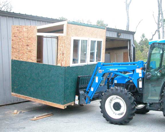

You can move it with rollers as suggested or you can use your loader if it has the capacity. I have a set of Woods 4000# forks on my TN and made a set of 10 foot extensions from channel iron. The shed in the picture is quite heavy as it has a lot of framing and waferboard sides. I carry it around a fair amount.
Andy

Nice steup Andy. I don't think that my BX would be up to that task. I think I have tractor envy.
