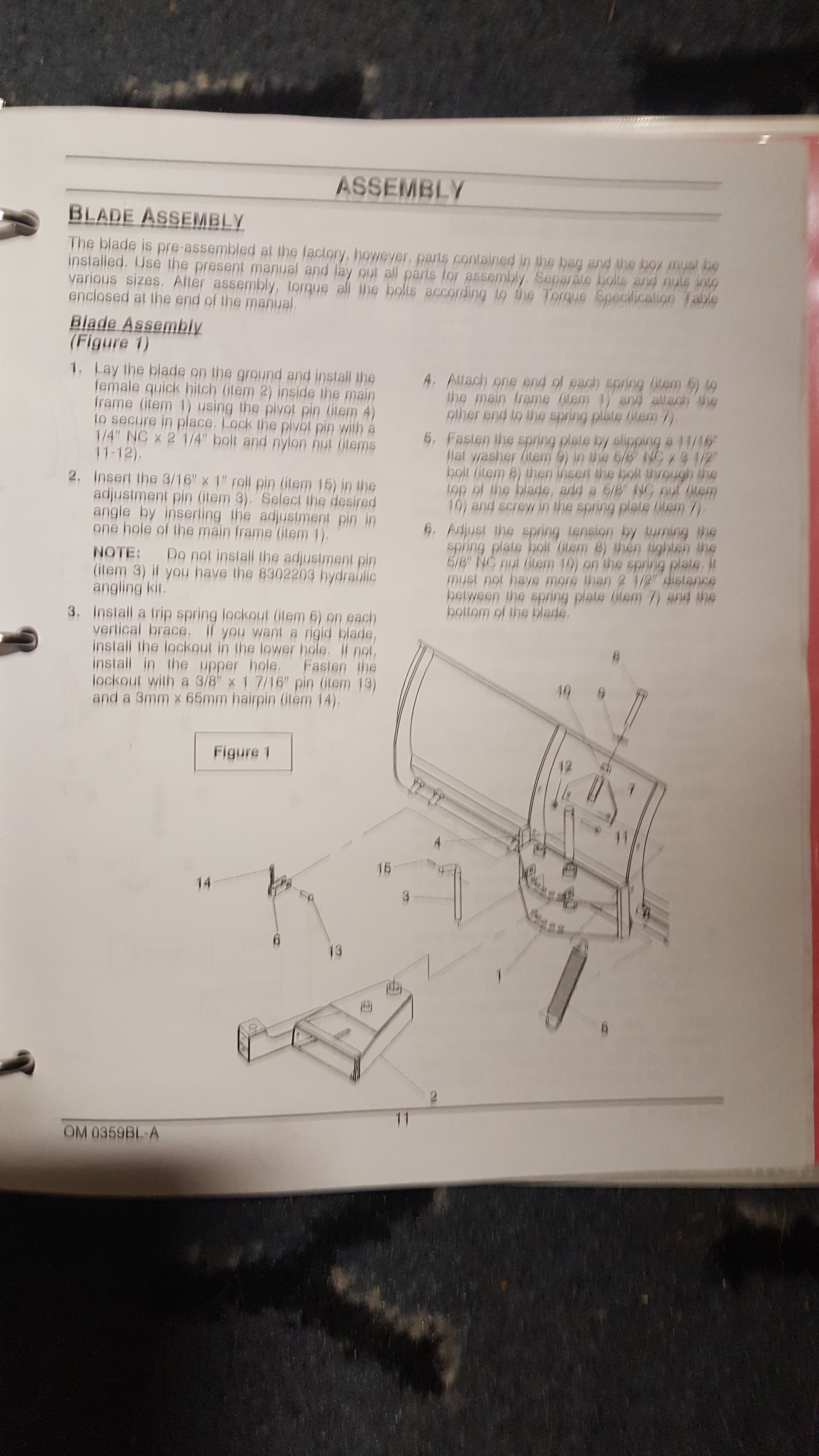

I recently purchased my first subcompact tractor, a used 2004 MF GC2300. It is in incredible condition for a 2004 and only has 325 hours on it. One of the reasons I purchased it was that it came with a 2340 quick attach dozer/snow blade. Attaching the mount to the blade is pretty straight forward, but mounting the mount to the front of the tractor is not (or at least doesn't appear to be although I haven't tried it yet because I don't want to remove the loader or the mower deck just yet). I actually have the operating manual for the blade, but it doesn't really get into mounting it to the tractor. It may end up being simpler than I think, but won't really know that until I actually try to do it. If anyone has any pictures or videos or basic instructions, I would really appreciate it. I have downloaded some pictures I found online, but they don't really show anything up close. My other option is to go to my nearest MF dealer (a little over an hour away) and get a look at a newer model (probably the GC1705) or get some instruction from the dealer if they are willing.

I have attached an additional photo from my MF 2340 Dozer Blade Owners Manual showing placement of the "trip spring lockout bracket", which I noticed was missing from your photo, this is not a problem if you plan on using the dozer blade in the non-locked out position.

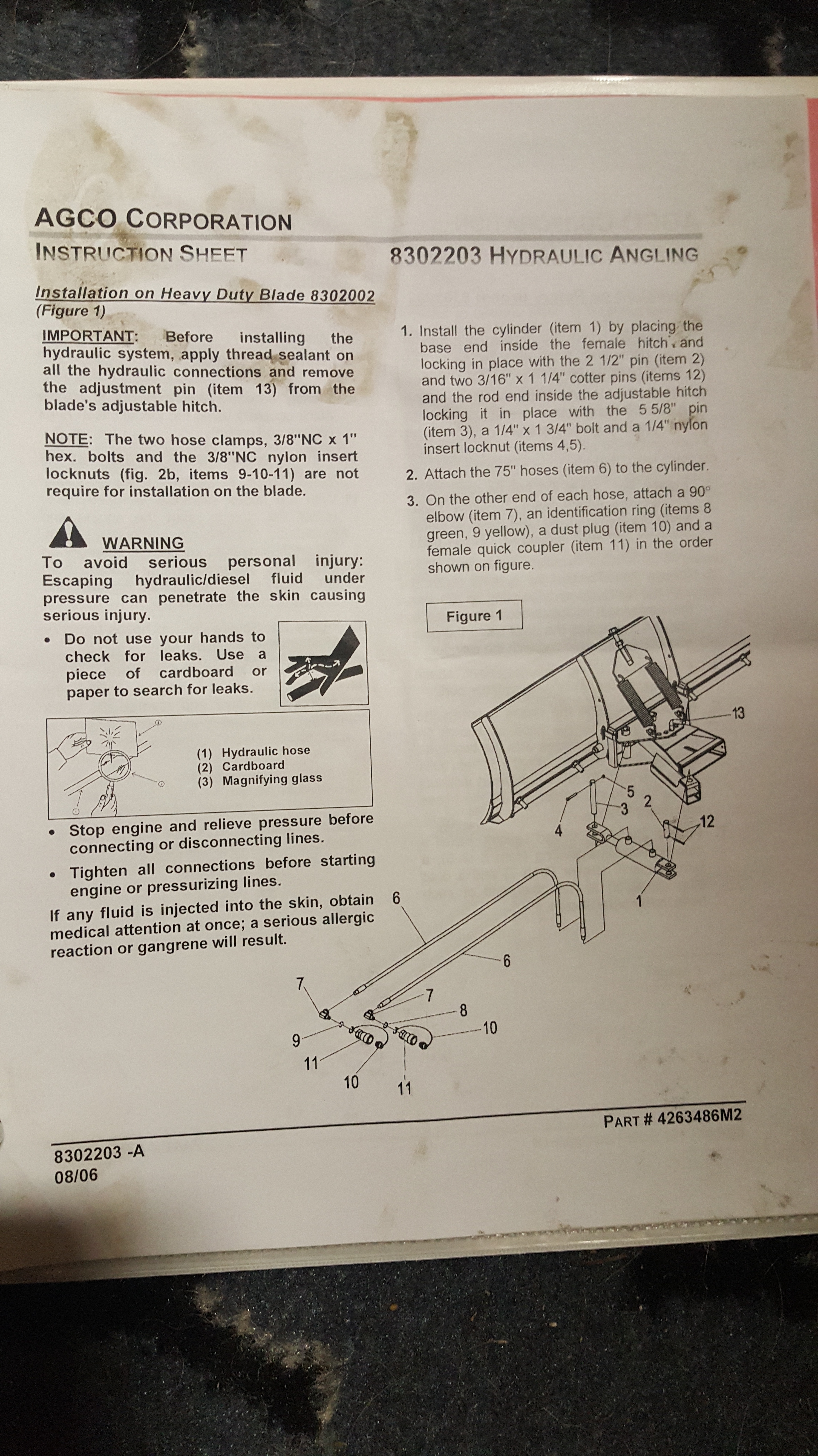

The last photo I attached is from my MF 2340 Dozer Blade Hydraulic Angling Kit Owners Manual, which I noticed you have with your dozer blade, this is a great add on to the dozer blade.

Great instructions to have. Thank you very much. That's one of those things when buying used...you don't always have access to the original instructions. I did end up with a number of manuals, just not much on the blade. The previous owner was very meticulous in maintaining the tractor and the manuals (they were kept in plastic and looked brand new). All of that to my benefit. Hopefully I can carry on that tradition. Thanks again.

Interesting -- that's the quick-hitch assembly, but apparently designed specifically for the blade: note the lack of the mid-PTO driveshaft carry-through like mine has (first pic in my above post) -- but I see it does have the extra hydraulic cylinder for angling the blade.

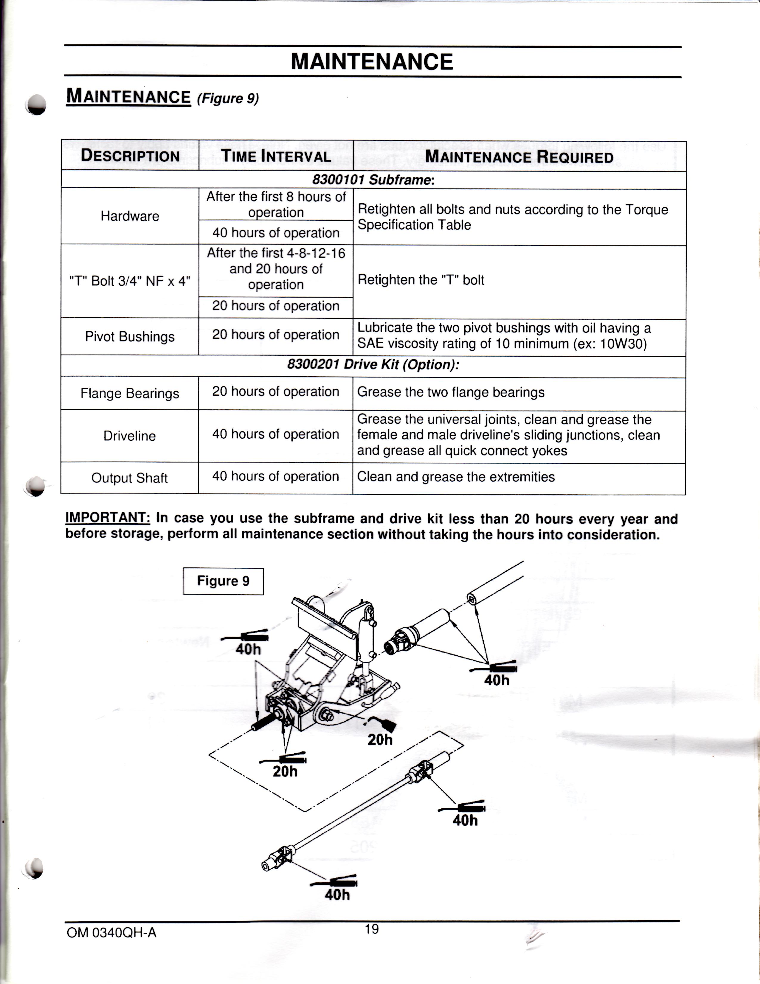

Regarding the T-Handle, the instructions provided by MF Red in MT makes a big point of checking and tightening the T-handle initially after every 4 hours of operation (probably due to loosening caused by impact or vibration). You are correct about there not being a hydraulic filter guard...I will look into that. Online I saw a number of homemade versions, but I don't have access to metal fabricating tools (nor do I know how to weld...at least at this point) so I will do a bit more research to see what might be available commercially. Interesting idea about the truck tire dollies for the FEL. I am going to look around to see if I can get some used. I already invested in some clamp-on pallet forks. I am storing the blade on a pallet in front of my garage so I plan on using the forks when winter come around so I can do the attaching outside on flat ground. It will also make it easier to put it back at the end of the winter.

MisterMike650 here's a couple of pics from the owners manuals regarding maintenance MF suggests for the Quick Hitch and the Dozer Blade.
irvingj sorry to confuse the issue regarding the Quick Hitch assembly for the snowblower, but that pic in post #5 above was the best one for showing the Quick Hitch installation, and here's a pic from the previous page of the owners manual showing the snowblower parts for the Quick Hitch.
Sorry if the previous pics are blurred as I snapped them with my cell phone, but now I remembered with the help of the wife to scan them from our printer to my computer, old age I guess, KC
B.T.W. the scanned pics sure do upload faster.

Am I correct in assuming at least the first and last pics are for a tractor with a front PTO for attachments such as a snowblower (which uses the same quick hitch assembly)? My GC2300 only has a mid and rear pto. My blade is fully hydraulic (four hoses just like the FEL). The quick hitch would appear to be the same (when I first looked at it, I was wondering why there were circular cutouts at the bottom which from your pics appear to be for the PTO linkages (which I don't have on my model).
