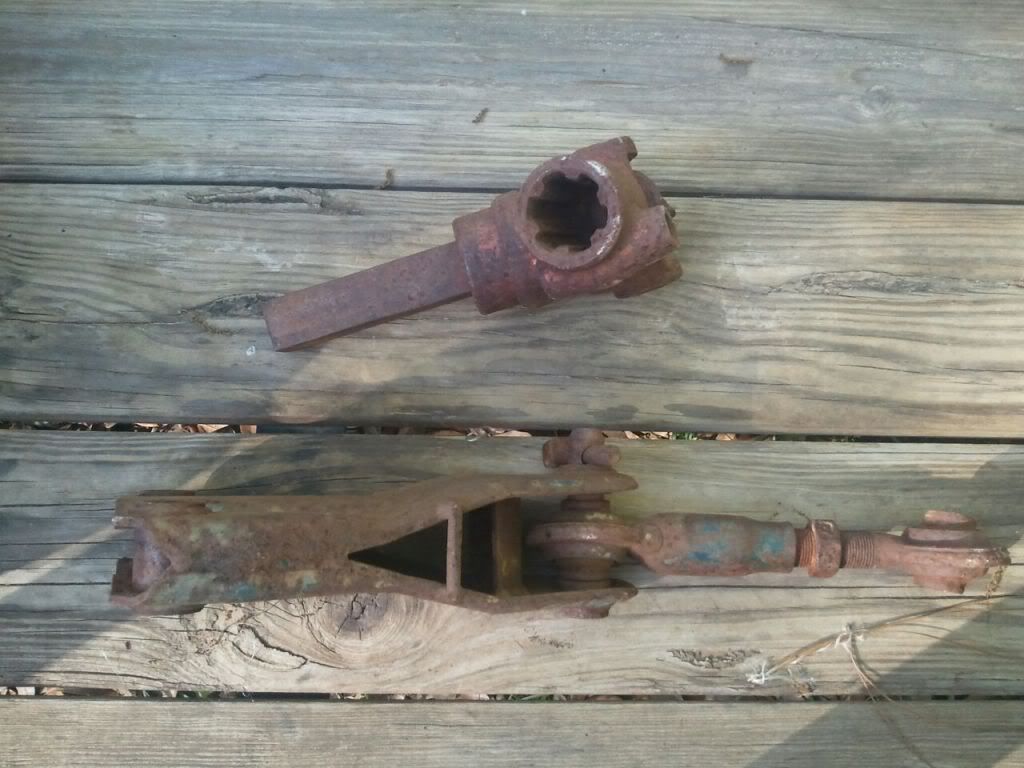

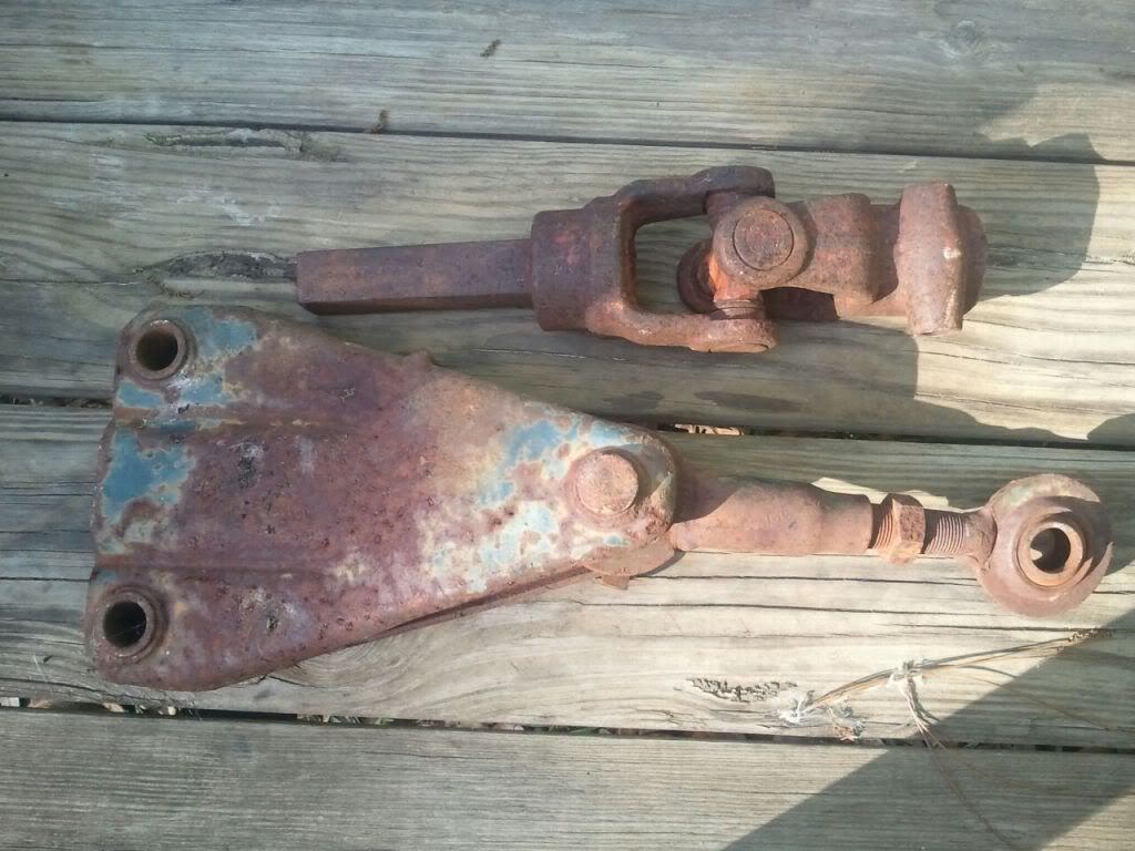

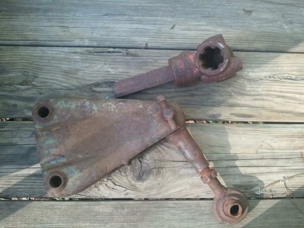

Here are my photos I just took this evening. Any help would be appreciated.

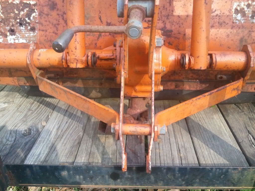

   / How do I hook up my Grey Market Kubota L1500 and RS1200 Tiller? #6
The triangular bracket pins onto the tractor, and the part with the ball attached to it pins onto the tiller. The shaft with the six splines female end hooks onto the tractor, and the square end slides into or over the square shaft coming off the tiller.
Two pieces off the tiller will attach to the lifting arms on the tractor; they aren't in any of your photos.
The tiller is on its face, basically. Roll it away from the camera 1/4 turn to be in operating position.
Be sure to check the lubricating oil in the side case. The other side of the tiller has a bearing that needs to be lubed individually. It does not get any lubricant apart from what is directly applied.
