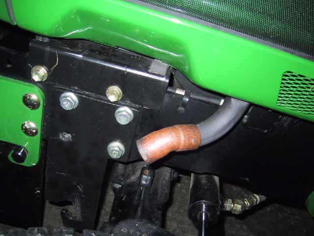

See attachment... Added a 45 degree elbow on the exhaust of 2210. Keeps the loader frame clean. /forums/images/graemlins/grin.gif
