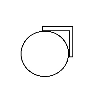

I need to drill some holes across a length of 8 ft tubing so I can make a harrow-type thing to smooth dirt. The holes need to be in a line so the tines are all equally in contact with the ground. How do I mark those holes on the pipe so they are in a line on the pipe and don't drift one way or the other?
Do I just hold a string across one end and then the other or is there a better way? The string way could still drift at an angle? I'm going to use a vise in a drill press so the holes will be straight going through the pipe but I'm not sure how to line up the starting line holes.
Any advice appreciated.

Clamp a piece of angle iron to the pipe, with the pipe in the "V." The angle iron should be smaller than the pipe, so the edge is your marking line. It can be a little smaller or larger than the diagram shows.

Make your line on the pipe with a pen. Angle iron as bcp mentioned works great as long as the angle size is 1/2 the pipe diameter or less. Clamp the angle to the pipe in case either the pipe or the angle are not perfectly straight. Then eyeball the length of it (from one end) to be sure it's straight & not spiral. If it's a little bent that's OK because each hole is still on the center.
Mark your points. Then with an angle grinder, put a little level 'ding' on the pipe that is a flatter surface. Since you ground your 'points' off, mark them again then center-punch, and drill on that new 'level' surface. If you want the dings to disappear, make them smaller than your intended hole size.

What could be any easier than what bcp suggested.
Once the pipe is clamped, just drill along one of the edges for a perfect line of holes.
Use small pilot bit for the first set of holes, then remove the angle and drill to the correct size hole. .

OK to get perfect holes "aligned" ...
drill the angle iron first with a small drill bit . . . . . . .
then clamp the angle iron to the pipe ....
drill thru the alignment holes ... ( drill can't wander ) don't worry about drilling at a bit of an angle at this point ...
remove angle iron ...
drill larger holes as needed ...
