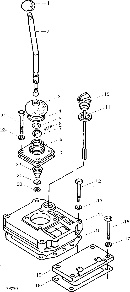

You could install a hyd oil heater. AR94493 Heater - HEATER ADD 81.87 USD How long since hyd filter was changed & sump screen cleaned? Hyd oil dipstick(parts key 10) is located by gearshift lever.
