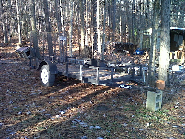

Guys & Gals,
I have a fellow TBN'er who wants to come over and bring his tractor (Bobcat CT122, no load in tires).
I have a 5x12 flatbed with angle iron sides, sinle axle, leaf springs, metal ramp, etc. (see pic).
I have managed to load 3 of my Harley's on it at one time, but was unable to lose tailgate so did not tow. I estimate I had at least 2200 lbs on the trailer at that point.
So, before I loan my trailer to a friend to tow a CT122 over to play tractors, how can I determine if it will actually manage this load?
I bought this trailer used and have no info on it.
Thanks in advance!
David

Just guessing, but it is probabally a 3500lb axle. Trailer probabally weighs ~1200lbs, Tractor weighs 2100lbs.
So....3500-1200=2300lb capacity. Plus ~500lb tongue weight would give you a ~2800lb capacity. Ok for just a tractor, But the loader would probabally push it if that applies.
   / How can I determine my trailer's load capacity? #6
I would not tow that tractor on a single axle trailer.
But for reference measure the diameter of the axle tube. I am guessing yours are about 2 1/3" That would make it a 3500# axle.
Figure trailer axle sizes, R and P Carriages
This chart will tell you what axles you have.
Most of the time on these smaller cheaper built trailers there are no brakes so even though they use a 3500# axle they de rate it to 2990# to keep it legal. Most states require brakes over 3000#. By doing this they build the trailer to 3000# specs. This is with the metal frame and more importantly the tires. Look at your tire load ratings.
Trailers I have sold like that in the past way about 800# empty so that would leave you with 2200# of legal capacity.
One other factor is that gate does not look up to the task of loading a CUT to me. You will bend it all up.

5x12 seems to not be a std size.
There is a weight lable, I can't read it, but I believe the trailer was purchased/built at Diamond C Farm Equip in Lyon's VA probably 10 years ago or so.They are out of business as far as I can tell.
Chris,
I suspect you are EXACTLY right on the weight limits. Most similar trailers I can find online are 2990.
As to the tailgate, I can take another pic, but it is metal mesh welded to a fram made of 1x2 rectangular tubing. The hinges are welded at both ends, the tail gate is removable, the pin side is on the trailer, I think there are 4 of them.
Is the mesh the weak spot, or the tubing?

sorry- chris is right- the trailer you got is pretty much too lightweight for a cut tractor. your mesh gate will bend as there is no supports where tires will go.
