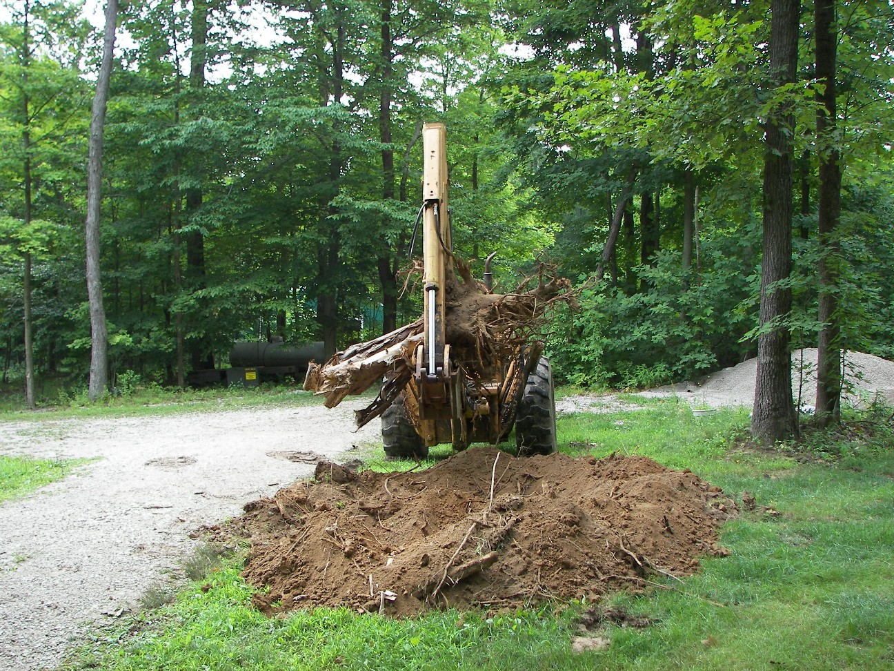

Obviously if you dig out enough it will work. The question is how much can you dig out and still be comfortable with it not falling on you or out of control. If you can get it to lean you get the advantage of the weight of the tree pulling itself over. I had what I believe to be a hickory (10"-12") get blown over in a storm (it had a damaged trunk and snapped off) and thought I would test out my new BH65 backhoe. I dug all around it and could not get it to budge, which took quite a while to do (small backhoe). So I just decided to get my full size TLB (12K - 14K lbs) and just push it over in the hole and drag it out. I hit it and it still didn't budge. You can see the dig marks in the drive where I pushed against it. I ended up digging it out with my full size TLB. So my guess is, it being hickory it has a pretty good tap root and you would have to dig out pretty good around it. You have a pretty big machine so you might have better luck than I did. If it is a fairly symetrical tree (not leaning) you might tie it off with a safety line with tension as a safety measure. I have done this with trees before when cutting them with a chain saw. They were only 3 feet from the side of my garage and I did not want them having a chance to fall back on the garage/house.
