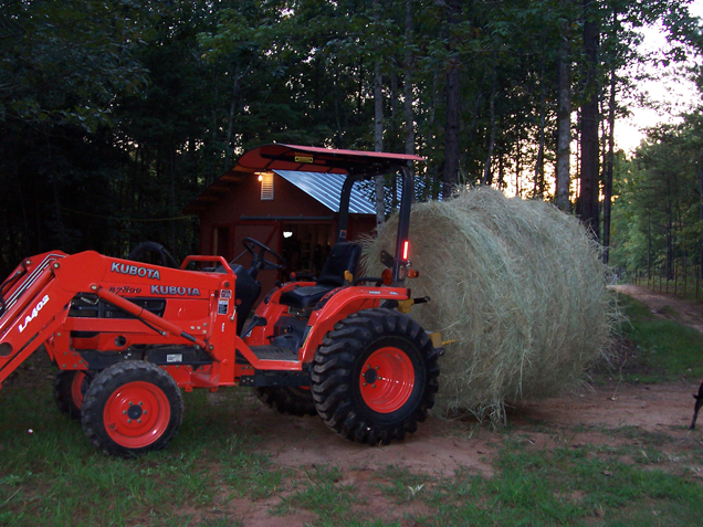

Jimmy,
First welcome to TBN. Hope you find as much good info here as most others do.
I know I'll get some flak on this, but I've been moving 4x5's with my B series for years now. A few things. I don't travel very far. From storage to feeding area is maybe 300 feet. I also don't have slopes to cross or rough terrain to deal with. That said the B7800 can handle the weight and the size without a problem. I wouldn't put that much weight on the FEL, but on the 3pt. hitch it's not an issue. Also, if I was buying today and I knew I'd be handling rounds, I definitely buy bigger. L3400 at least.
I'm proof though, that anything bigger than my B7800 will carry a 4x5 with no problems. If you're looking to carry on the FEL though, I'd look at the L4400 or the mid-range Grand L series.
Good luck and let us know what you end up with.

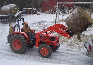

Yes a round bale on the fel does take a bit more tractor. But it amazing what you can do with ANY size Kubota!!!!
Kubota's MTach pin on bale spear is a very strong unit.
