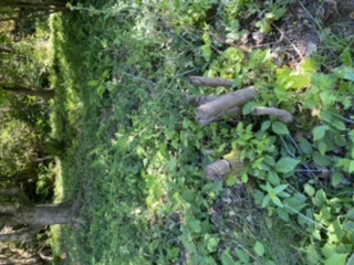

I have a compact tractor that i am still getting familiar with. I have couple acres of an area filled by a dozen or so holly trees that i'm trying to clear. The trees will be chop down and worked on, but what i'm trying to also accomplish is to make the area more walkable. Right now, after years of neglect, it is filled with gopher holes, uneven ground, seasonal blackberry ground vines, small holly brush and old shallow roots, and lots of ferns spread throughout. What is the best way to tackle this? Would a landscape rake be able to rip shallow roots and a create a rough grade that i can then use a box blade later? The area is also on a gentle downslope as well.

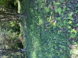

i have a toothbar on my bucket, stump bucket. I have attached a few pic. Most volunteers are from holly, hazelnut and poplar variety. The numerous ferns are everywhere

That's not as grown up as I imagined. My concern with the toothbar on the FEL is potentially getting hung on a stump or rock.
What about a pull behind spike drag harrow?

i tried using the toothbar, but with the uneven ground, i kept digging into the ground instead of an even scrape over the surface. Maybe i just need more practice:)
   / How best to clear shallow roots and vines and fern #10
Rotary cutter, then Fred Cain plow.
