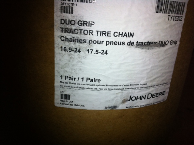

Hi guys, I was wondering if any of you knew how tractor chains are sized? I ordered chains from the Deere dealer for my tractor, a Deere 4120, with 13:6-28 R-1 rear tires. The dealer called me up and we loaded a set of 16.9-24 17.5-24 chains in the back of my truck. I just tried to fit them over my tires and there is considerable overlap. Should I try to cut the chains to fit or send them back to the dealer and ask for the proper chains. They are duo grip chains

The 4120 came with 24" OR 28" rims and tires.Probably 24" R4 ? Chains are made to fit the tire,you have the wrong set.Look them up at Tire Chains by TireChains.com under tractor chains.
   / How are tire chains sized? #3
Tire chains often fit more than one tire size. In this instance, you have the wrong chains for your tire size according to the chain retailers I checked.
   / How are tire chains sized? #4
The chains Deere gave you for 16.9-24 and 17.5-24 tires have cross chains that are likely too long.
Take a look at Quality Chain's online catalogue and download a LaClede catalogue. They specify different chains for your tires as follows:
Quality Chain: DUO242 chains that have 10 patterns of DUO294 crosslinks which are 11 links long measuring 22"
Laclede: DUO260 chains having 10 patterns of DUO296 crosslinks which are 13 links long measuring 24.95"
The chains Deere sent are likely DUO262 (Quality Chain) or DUO263(Laclede) with 8 patterns of DUO297 crosslinks with 14 links measuring 26.5"
I am not certain of the above specifications. I had a heck of a time getting chains for my 43x16-20 R4's last year. I had to send the first, far too large, set back. Quality Chain changed the specification for my tire in mid-season last year from DUO239 to DUO242. This year, they are back to DUO239 but the DUO239 cross link pattern has changed.
I'm in Canada and found Quality Chain very helpful when I called for information. The same company in the USA may be the same. Quality Chain sells through canadianchains.ca here and they were also very helpful. Likely they sell through TireChains.com in the USA.
I prefer to have more patterns with shorter crosslinks for a smoother (but still very rough) ride and more coverage. But they will ride higher on the tires. I also need that because I have very limited clearance to the fender support with non-adjustable, one piece rims. My chains had a fair gap at the connection and I filled them with 2 straight crosslinks (i.e. non DUO).
I may eventually cut back the DUO crosslinks (from 13 to 11 links) on my chains to get them higher on the tire. I would need to fill them in with one or two more DUO patterns.
I think it is better to have extra patterns and ride a bit higher on the tire and cut them back if necessary. Another option for adjusting the closing gap of the DUO's would be to shift some patterns to eliminate the 2 link gap. i.e. connect two adjacent patterns to the same cross hook similar to H pattern small tractor and mower chains.

Thanks everyone, I took the chains back to my dealer, they ordered another set which ended up being ladder chains. I left those at the dealership and they delivered the proper sized duo chains for my tires. It took a year and a half since I got the first set but, you know what they say, third times the charm.
I appreciate everyone's help!
