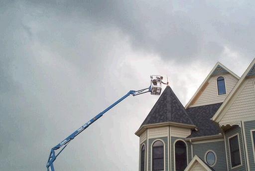

I have a problem (more than one to be sure /forums/images/graemlins/wink.gif )
My chimney caps need to be replaced. They are a flat concrete cap (4" thick, say 24" x 32" for the small one, and the big one is nearly twice as big). The small one is falling apart and I'm afraid it will soon collapse into the chimney. So, I ordered and got new limestone ones and I need to get them up there. I have a ranch, so height is not really the problem, but I have a ceramic tile roof that really prevents me from just getting a bunch of big guys up there and trotting around. I was thinking maybe a bucket truck? Any ideas? /forums/images/graemlins/confused.gif

You can rent an ariel lift at some homecenters now. This is one I rented from Lowes/Nationsrent last year to put a finial on our roof /forums/images/graemlins/smile.gif

Just remember the bucket trucks are designed for a person and they are not a crane. A slab that size could weigh more than the person in the bucket. Tippy, tippy, tippy! /forums/images/graemlins/shocked.gif
Just something to consider. /forums/images/graemlins/laugh.gif

There are a variety of lifts (as mentioned and like the one pictured) that can be rented, but a limitation that I find is the distance out from the base that they will reach. Height seems to be no problem, but 'reach' seems to be limited due to balance and the carrying weight. Seems most I've rented are rated for about 500 pounds (two men).
Some of the other ideas presented might work for you.
