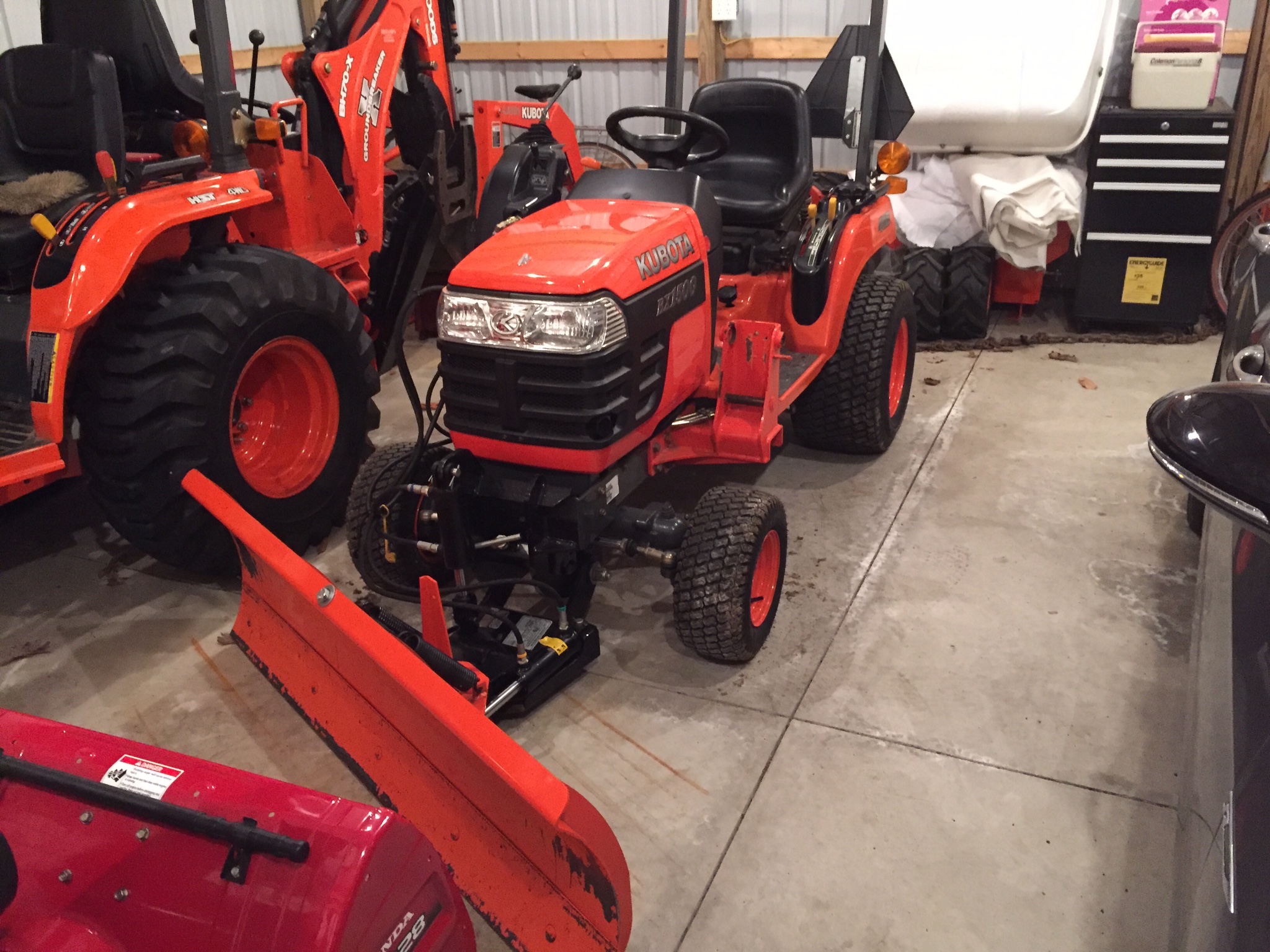

I owned a BX1500 for a year and a half. I bought this used and traded in a 2wd Case IH 1130 for it. My BX1500 had 181 Loader, 54" deck, Kubota 3 bin rear PTO bagger. The biggest complaint I had with the machine was the limited capacity and size rear 3pt lift. Not many standard cat 1 attachments fit the BX1500. I had to cut down the frame on a King Kutter 48" rear bush hog to make it work. I even used a duplicate vertical arm so I could get more height and lift from the 3pt. I doubt it could lift any regular sized bale. It would barely lift my 450 lb rotary cutter.
The loader is nice on all Kubota BXs this is the smallest one and has very limited lift capacity 300 + lbs.
The 2 cylinder diesel engine is extremely rough and lumpy at idle. The BX1500 uses a large static counter weight to counter act vibrations. I had to replace a mount for the weight because I let the engine idle too much.
Great grass cutting machine. Probably the best BX for cutting grass my BX2370 feels a little large for trimming in close to objects. The BX1500 was like a garden tractor on steriods.
