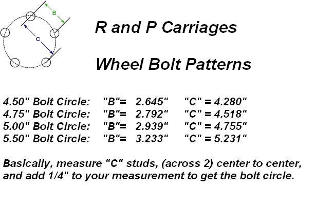

I think my trailer on my boat is 5 on 4.5 and my utility trailer is 5 on 5 lug pattern. Either way, they are different eventhough they are both 15" wheels and 5 lug.
Here is how you measure.

   / How about a spare tire for my trailer #9
Surprised that fit! GM are usually 4 3/4 or 5 inch bolt circle. My friend does have a landscape trailer with the Chevy bolt circle. Somewhat unusual I believe as most are 4 1/2 inch.
A lot of older Ford and Chrysler products have the 5 x 4 1/2" pattern. GM are mostly 5 x 4 3/4" or 5 x 5" as mentioned. See Chris' chart to make sure you are measuring correctly.
