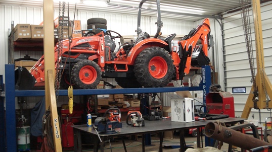

First thing you need...12k lift!:D

BTW Rick, I like your KL130 Gantry Hoist

Great idea. Can I borrow yours for a few days? :D
I was even thinking of using the backhoe to dig a trench then drive the tractor over it so you'd have stand up room to work underneath. Don't laugh, in less developed countries that is exactly how they work on big trucks etc. It's a little inconvenient when the water table is about four feet down in springtime though.
