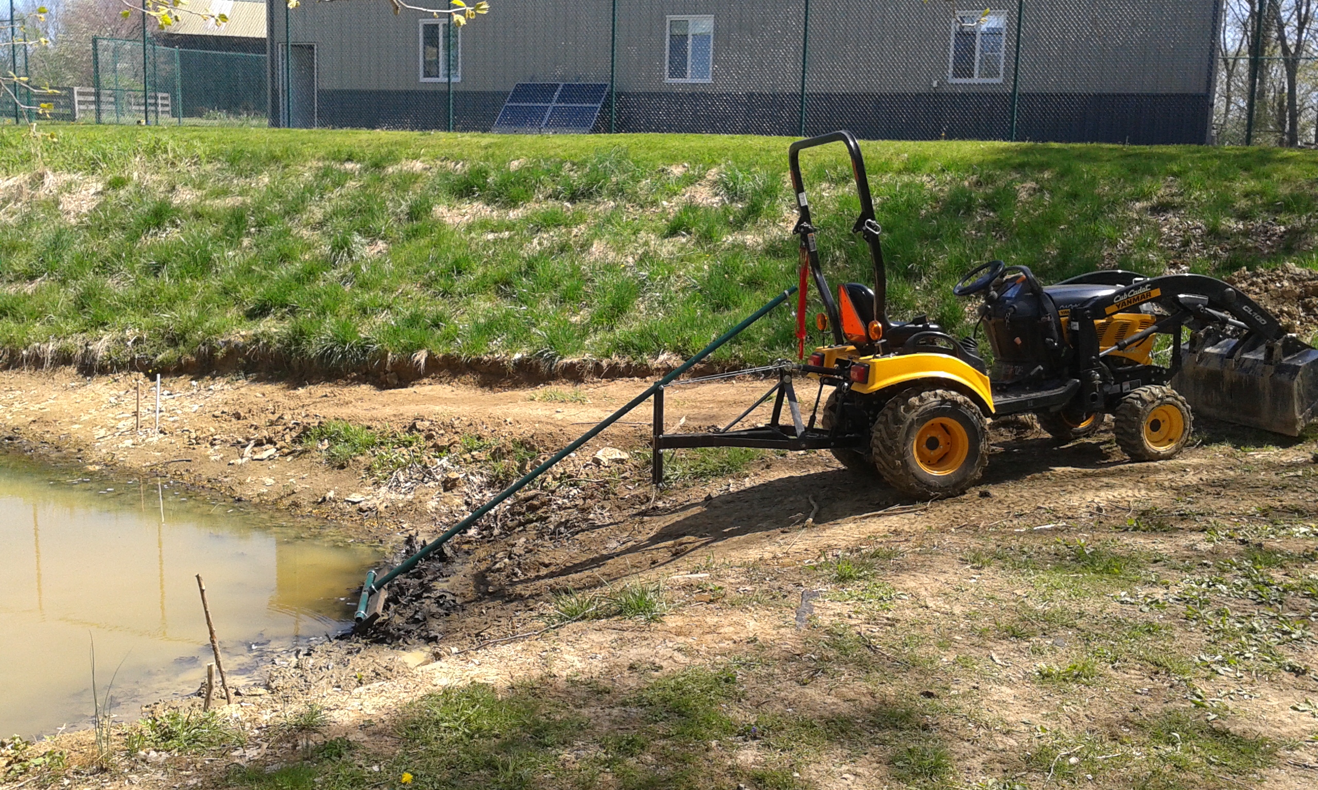

Good Luck and if you have any please reply to or repost - My green helical gear at the inst cluster has a couple broken teeth. I have searched hi and lo for a gear - the whole inst cluster is not available - manuf says discontinued - I don't think they ever made any spares. May have to go to an electric tach and hour meter.20160424_114950.jpg

What is the set up on the back of the tractor, used for?
