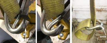

Here's an easy project for a rainy shop day.
582394d1544394821-hot-rodding-your-2-ratchet-ratchet-strap_hotrod-jpg
1) with an angle grinder cutoff wheel, cut the corners off the hook, so it drops thru slots easier.
2) weld up the crotch of the triangle so you can stuff the strap thru the triangle and use it as a slip-knot. Otherwise the strap gets wedged into that crotch and you can't get it out.
There's plenty of time to weld it and quench before the heat arrives at the nylon.
I welded it then sprayed with water.
That's a good idea!

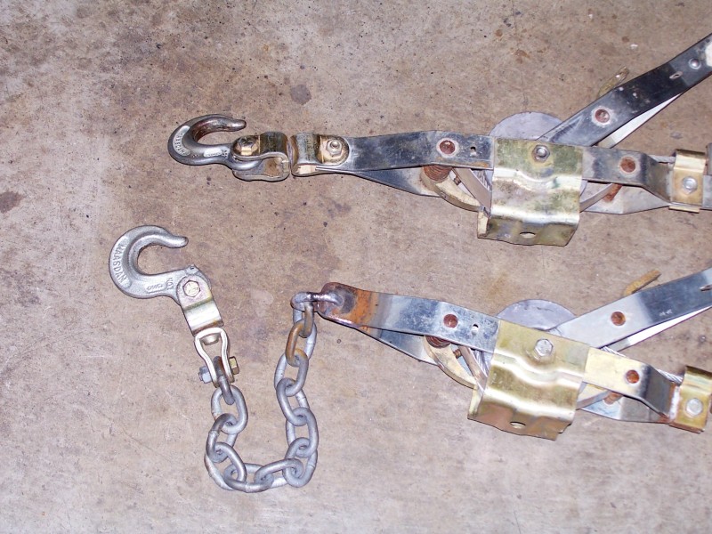

Since we're on the subject of handy mods, here's one for a come-a-long if you don't have something for the hook to anchor to, like a wooden post, and you don't have a make up chain.

I just bought 8, 1-1/2" ratchet straps with those stile hooks, dont like them but was $30.00 cheaper that the ones with regular hooks. I was wondering if they could be spot welded before melting the webbing, but your webbing looks more heavy duty then mine.
