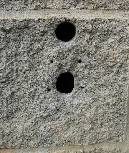

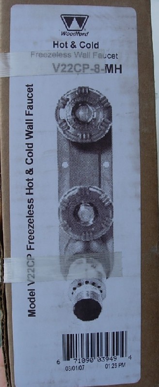

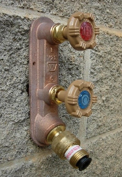

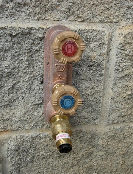

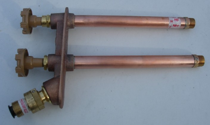

Had an idea that it would be nice to have hot water available to me outside...
Now I know it was a good idea. Took some reconfigurating (;) ) inside but since we wash the dogs outside and are on a well, I thought the least we could do for them was make the water warm!
:D
About the only thing I've found wrong with this idea is if you use a hose, it can take a bit of trial & error finding the right "mix" of hot/cold to get warm because of the lag time from faucet to end of hose.
Woodford Home - Freezeless Faucets Wall Hydrants and Yard Hydrants
For the record, I'm not affiliated with Woodford at all, just wanted to show/share what I thought was a cool idea.
