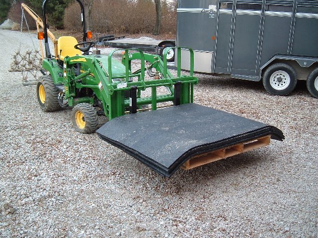

The ones I have from Horst mount just like the bucket. They are a snug fit on the loader and even came in J.D. green!

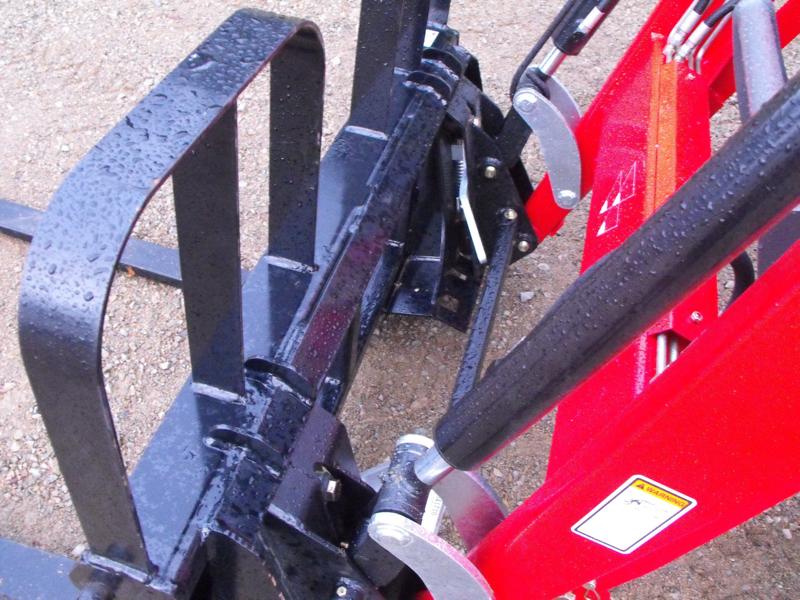

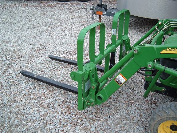

I have the Horst model RD65BO500, just got it yesterday. 48" forks, rated 2000lbs, quick attach. I'm not sure what you mean by "top clips".

The JD QA for FEL implements has a bracket at the top shaped like an upside down "U". That's the top clip the OP is referencing.
