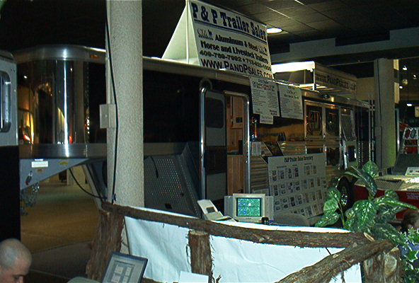

This three horse slant caught my attention at the rodeo...$52,000+ show price, $58,000+ list. My house on a 100'x100' lot is worth around $30,000...go figure.

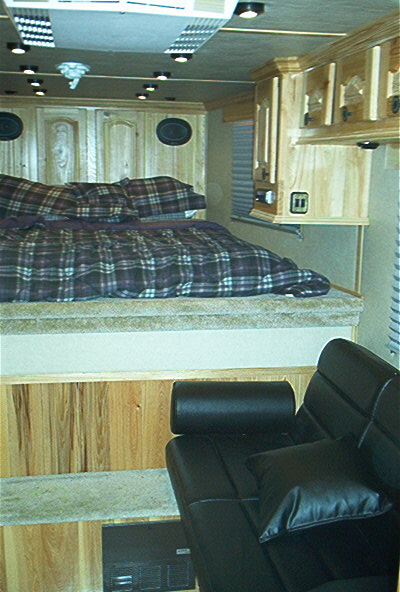

From the head, facing forward.
