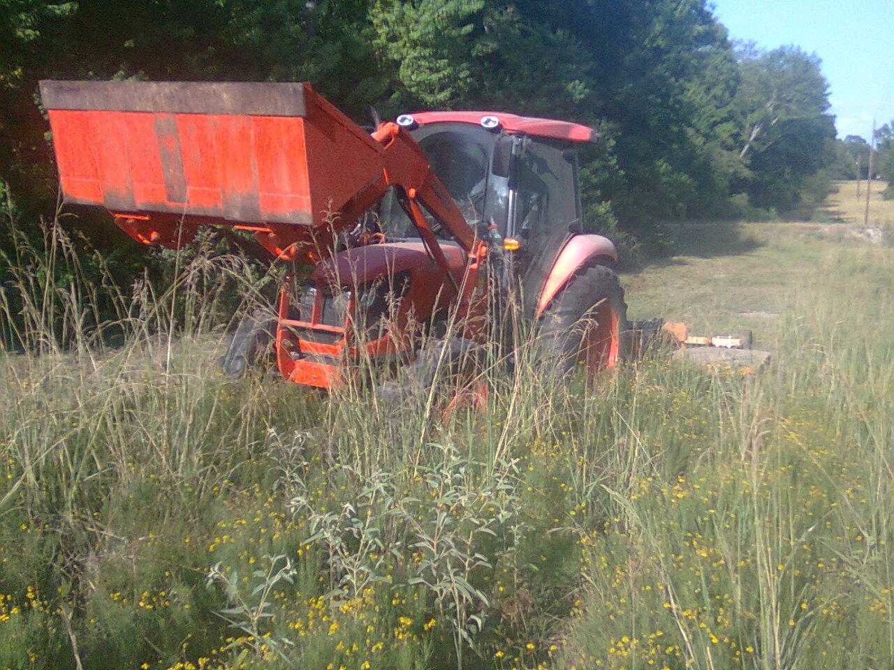

I have a IH Farmall 706 and an old tank Bush Hog M160 13' 3 spindle mower (flat - not a bat wing). The tractor has 89 HP engine, 65 HP drawbar, 73 HP PTO (when new); weighs in the 8,000 pound range.
I personally wouldn't want a larger RC with my tractor size, unless it was only to be used for light mowing. The 13' with 73 PTO HP in 5' tall weeds is a pretty good lug. I mow at 4 MPH (3L), but have to use the TA on heavy patches when the engine starts to lug.
Personally, I think you need a 90 HP PTO or larger tractor. Even if you are only planning on mowing thin and short (light roughage) - unless your acreage is pretty flat - you will need a pretty heavy tractor or that batwing will pull you instead of you pulling it.
