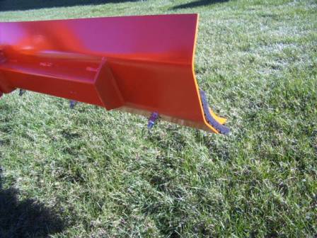

I got mine at TSC, I think this is the one:
http://www.mytscstore.com/detail.asp?pcID=6&paID=1045&sonID=182&productID=1312
They have about 3 different kinds. This one is 4'X6' and about 3/4" thick. It was $39.99. The top is smooth and the bottom has 1/8 wide by 1/8" deep grooves about every inch apart running the long ways. The grooves make a nice line to make a straight cut. I put a 4X4 under mine to raise it up and then used a jigsaw with a medium tooth blade. It cut it like butter, very quick, easy, and straight. I have heard you can use a table saw, but might want to put baby powder on the table to help it slide. You might also need some help, because the mat is a bugger to manuever since it is about 100 lbs! I had a heck of a time getting it in the SUV for the ride home. I can't comment on the durability yet, haven't used it yet. Here is a pic of it mounted.
By the way, I only used about an 8" wide piece of the mat, so I plan to use the rest of the mat for removing the loader on my epoxied garage floor so as not to gouge the floor. I think a mat like this has a lot of uses.

How is the stall mat secured to the blade?
