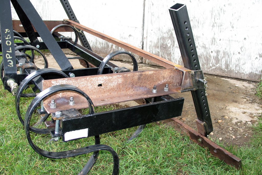

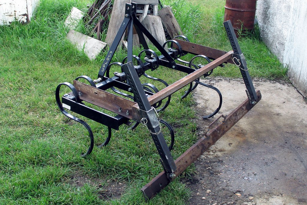

The main tool I use for our outdoor riding ring is a modified s-tine cultivator. See the attached pictures. It does not pulverize the soil but it does break up the soil for better footing, at least my wife and her friends like it. The balde helps to level the ring as well as acting as a gauge. It is set 2" above the tip of the tine so I don't go too deep. The soil is sandy on top and the wind does blow it around if it is broke up too much.
Once a year I do roto-till the ring. After that I drag it with diamond harrows which seem to help to pack it a bit. I do pray for rain after I tiller it.
We are just finishing a two day clinic and the ring is holding up very well.

That s-tine cultivator looks like just the thing. I'm sure it works better than a box blade.
