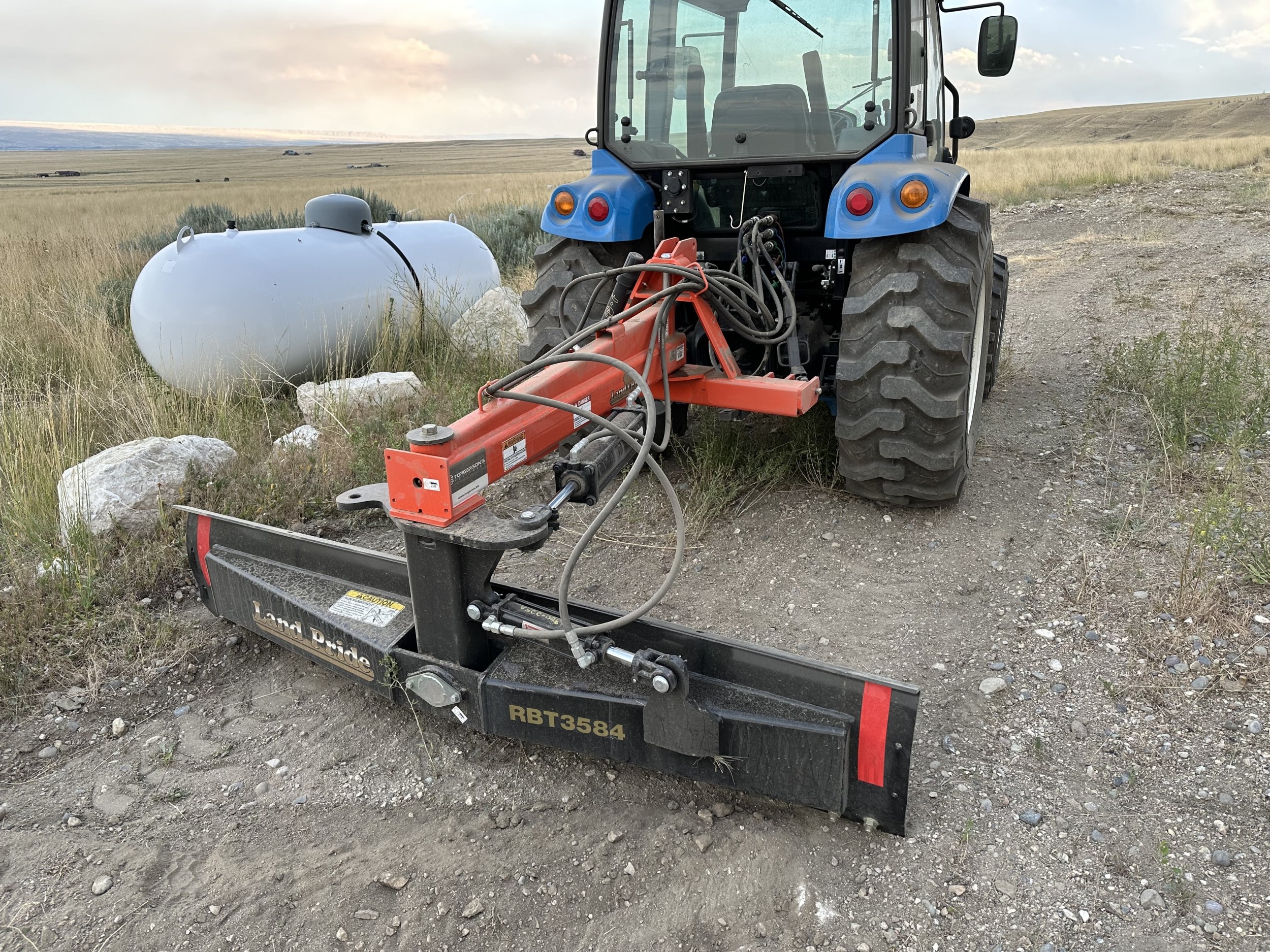

Bought a lightly used Land Pride RBT3584 yesterday and did some work with it behind my LS MT357HC (57 hp hydro). Never used a rear blade before but this thing is a cutting beast. It has all three cylinders (tilt, angle and offset). It does not have the side plates, skid shoes or tail wheel.
Years ago I had a cheap box blade that I eventually broke getting too aggressive with the scarifiers. Before I broke it I could get the fire perimeter around our place looking pretty good. Not sure I will be able to get the horse arena look with only my rear blade. I have almost zero experience with a my new blade but it just doesn't seem to deposit the dirt like a box blade.
If I add the optional side plates and tail wheel to my RBT3584 can I get that horse arena look or should I be shopping for another box blade? I'm guessing removing the blade with three sets of hydraulics will get old pretty fast. If I can get the look I want with just the rear blade I'd prefer to go that route.
Thanks for any advice and looking forward to seeing some photos from you guys that have tail wheels and side plates on your blades.

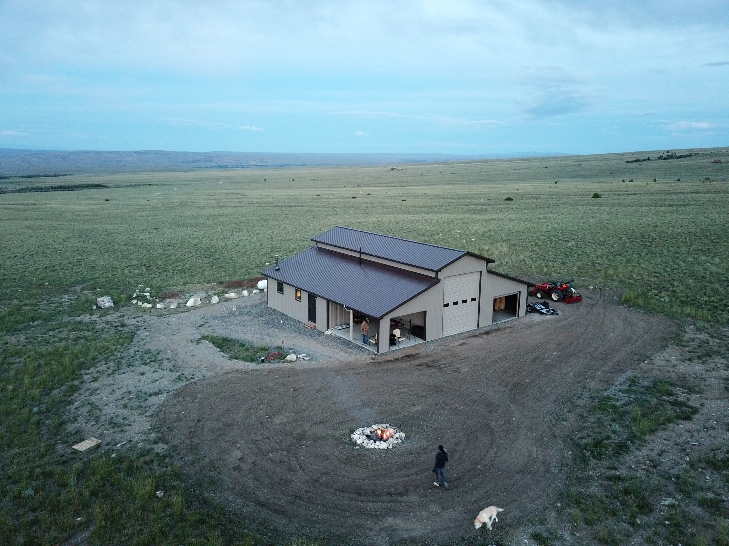

This is what I accomplished years ago with my box blade:

The side plates do allow a rear blade to move dirt more like a box blade. IDK if it will meet your expectations. That’s a nice blade you have. I have the same size blade with similar functions made by Bison. Personally for my uses, a well equipped rear blade is better than a box blade and is more versatile. Something you can try if you’re just smoothing loose dirt is to rotate the moldboard 180 degrees so the cutting edge is facing backwards. I do this often for final smoothing or to plow snow on a gravel road that’s not yet frozen.

Thanks. I'll give the reverse trick a try. I was looking hard at the Bison blades new until I found my lightly used LP blade. Guy traded in a Kubota and the blade with only 24 hours on the tractor. Go figure.

That is a nice heavy duty blade. I think you'll find that adding a tail wheel will allow for a very smooth finish. I had gauge wheels on a 7' rake, and it made all the difference in getting a smooth finish.

Thanks. Do you feel hydraulic is necessary for the tail wheel? Land Pride has both manual and hydro options. I'm out of remotes but could swap the offset for the tail hydro when needed. I'm sure the hydro version cost a fortune.

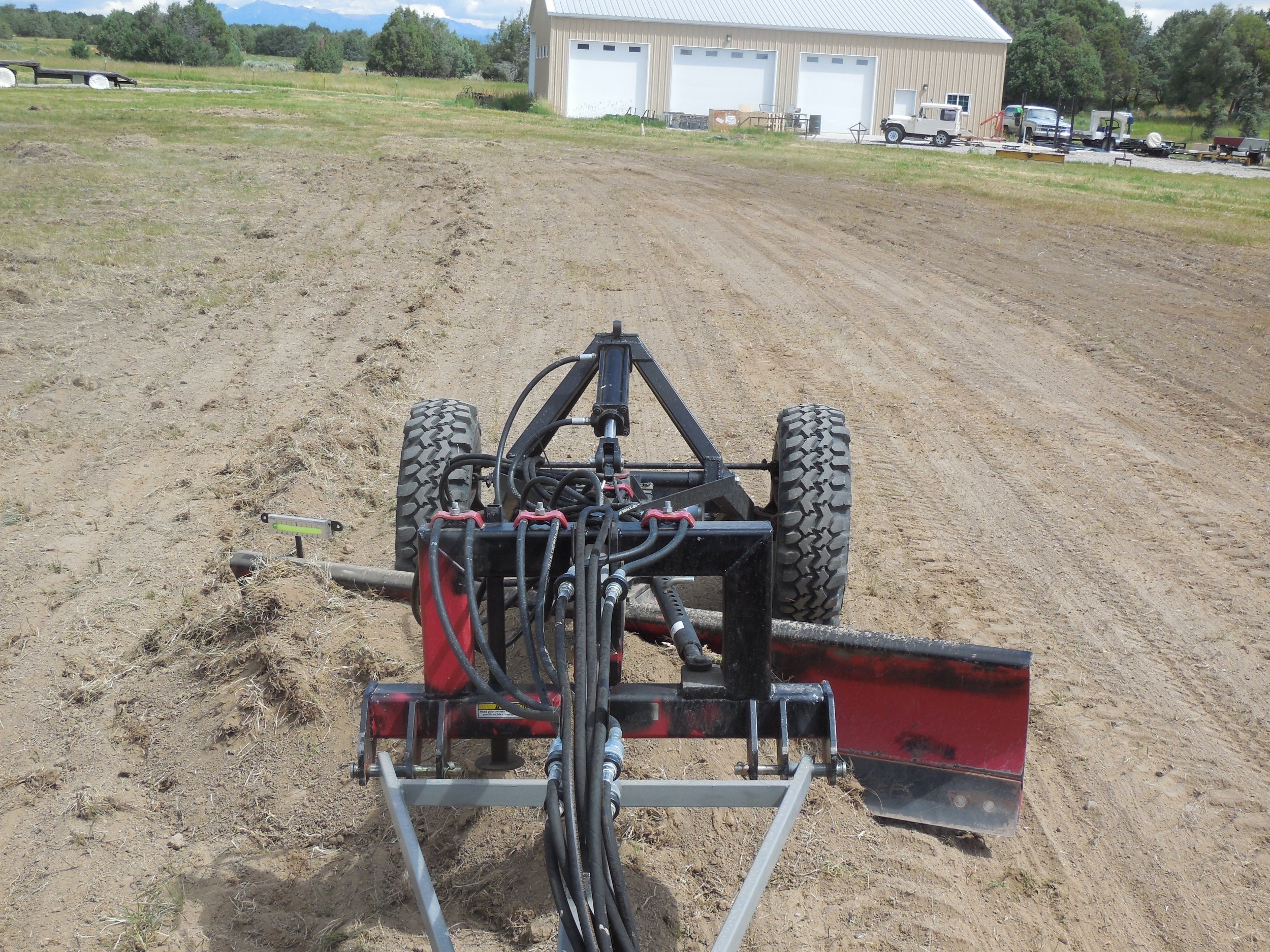

I've used a rear blade on my driveway for 44 years. The problem - a rear blade just isn't a road grader. Even with my hydraulic top link - it just does not make things perfect. It's a HD - 1000# - Rhino rear blade.
Five years ago I bought a Land Pride - land plane grading scraper. It's a real joy to use on my driveway. Driveway is a mile long - gravel. It makes the driveway as smooth as a pool table.
As I see it - you have three choices. Each is an increase in price.
1) reverse the rear blade and just drag it. Round and round you go. It will end up smooth.
2) get a rear/tail wheel for your rear blade. It will help but it still isn't a road grader.
3) get a land plane grading scraper. It should do even better than a reversed rear blade.
If it were me - I'd first reverse that rear blade and see if it doesn't do a good job for you.

Problem with gauge wheels in riding arenas is the footing tends to be soft allowing the wheels to sink and blade too. A box scraper works well for this task.
