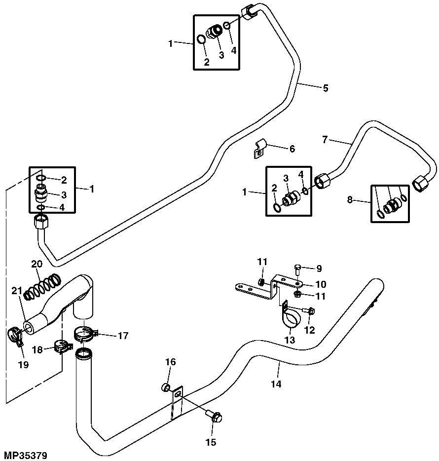

I have a 3320 compact John Deer tractor that must be running at 2000 rpm plus for power steering and all hydraulics to including forward and backward motion to operate. Any suggestions before I change out the hydraulic pump?

Suction leak?
Have you put a pressure gauge on it?
Have you cracked a hose open and see if its flowing just not developing pressure?

Thanks for the pump information. The history is; last fall I changed the suction filter and hydraulic oil. I went to dealership to get both. I was given Hy-Guard hydraulic oil. After a month or so I noticed the tractor did not move very quickly when cold. Just cold I thought. I still had about one half gallon left of the oil. Read on the label and it was not low viscosity oil. Fearing the wrong type oil in tractor, picked up new oil (low viscosity) and new filter. The hydraulics are getting worse every use. I have checked the level many times. The oil on the hydraulic dip stick is very clear. The tractor has 1600 hours. Don't know what to check. After reading on Tractor by Net I am about convinced there is a suction problem either a hole or connection not seated well. I am about to drain the hydraulic oil to check filter and suction pipe for proper seat. After all this history can anyone offer a different solution?

There is little difference in the regular Hygard and the low-vis flavor, is should make no real difference. I would pull the filter and screen though, just to make sure it's still clear.
If there is suction side leak, then the fluid is usually foamy after running. One common failure point is the "manifold", part #21 (M134346) below, it can get hard and crack causing the system to suck air with no visible leaks. Next step is to get a tech manual and a pressure gauge to run some tests.

Turned out to be the manifold had a crack and tractor responded different with the temperature. Changed the manifold and everything works great. Thanks to Tractor By Net members for the help. I learned a little more about this tractor. Not a good idea to trade tractors when you have knowledge of the one you own..old timers kept the same old tractors for years because they learned how to work on and fix the tractor they had.
